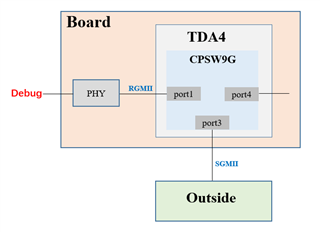

My project use sdk8.2 with QNX+RTOS environment, the connection of ethernet is as following:
I'm having problems with how to use the ALE feature As I know, there exists a MAC/IP address on R5F 2_0 /RTOS in SDK, which is used for PTP and so on. So at startup, there will be an ARP announcement broadcast message out from R5F 2_0 to LAN. But this IP address is not allowed appeared outside of TDA4. In my project, not allowed foward to port3.
I think maybe ALE is the best solution. Via configure ALE rule to disable this special message pass to PORT3 to outside, but allow it pass to PORT1 for debug. And not affect other ARP broadcast message pass to PORT3 at the same time.
I still don't deeply understand about ALE, although I have seen the following docs. https://e2e.ti.com/support/processors-group/processors/f/processors-forum/1011237/faq-tda4vm-how-to-configure-cpsw-5g-9g-ale
1, I see in SDK, some just write an enter, and some write enter and policer. Could you please tell me, what is an enter? and what is a policer? What's the relationship of this two part?
2, For this issue, I see that, there already is an enter&&policer for ARP broadcast in SDK, that is ARP broadcast package will be forwarded to all port. And there also already an enter about R5F core MAC address to host port.

    2, I want add a rule to current ALE: If the src-MAC address match MCU2-0 MAC, and dst-MAC match broadcast, then is should be dropped at PORT3(othert port should forward normally).
    I find that the above two MAC address has already be used at TI SDK, and I need to reserve original rule in my project :
        (1). If the dst-MAC address match MCU2-0 MAC, then forward to hostport(mcu2-0 core). realized at entry function: EnetAppUtils_addHostPortEntry().
        (2). If the dst-MAC address match broadcast, and ethernet type match ARP, then forward to all port. realized at entry functon: EthFw_setAleBcastEntry() and policer function: EthFwCallbacks_setupArpRoute().
    Can this requirement of mine be realized ?  I find that if I add new entry of mcu2-0 for my need. it will cover original rule of above (1). Can you give me some advise ?
    You can Un-Mask Port-3 bit filed in above (0x1f7), so Broadcast packets will not be forwarded to Port-3.

    In my case, Conditions are packets from Port0 to Port3, SRC MAC is MCU2-0's, DST MAC is broadcast
    Here, SRC MAC and DST MAC policer rules apply only when packet is at Host Port (Internal port for consumption of packet by any application) and how to proceed further.
    It will not be applicable on External Ports.
    Can't this case be implemented with ALE?
    Your use-case may not be possible with ALE, as when ALE identified Broadcast packet it will forward to all ports as per Port Mask. If Port-3 mask is set then it will forward to Port-3 so, packet will be visible on external device connected to Port-3.
