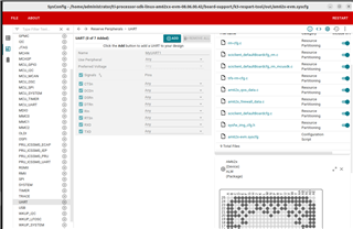

we have installed sysconfig tool and tried to open the . After  opening we couldn't see configuration reflecting the am62x EVM board. like UARTs not being assigned and same with other peripherals.
could you please let us know from where to download default sysconfig file for evaluation board.
we have attached the file from sdk out folder.

  • Hi Swapna,
    Keystone3 Resource Partitioning tool is used for partitioning various system level resources to different software components in a multi core SoC. These resources include DMA channels, NAVSS rings, proxies, interrupts, etc. The default configuration file will not assign any peripheral like UART, SPI etc for EVM board. You can manually add them using sysconfig tool according to your usecase. For more information please refer K3_Resource_Partitioning_Tool.
