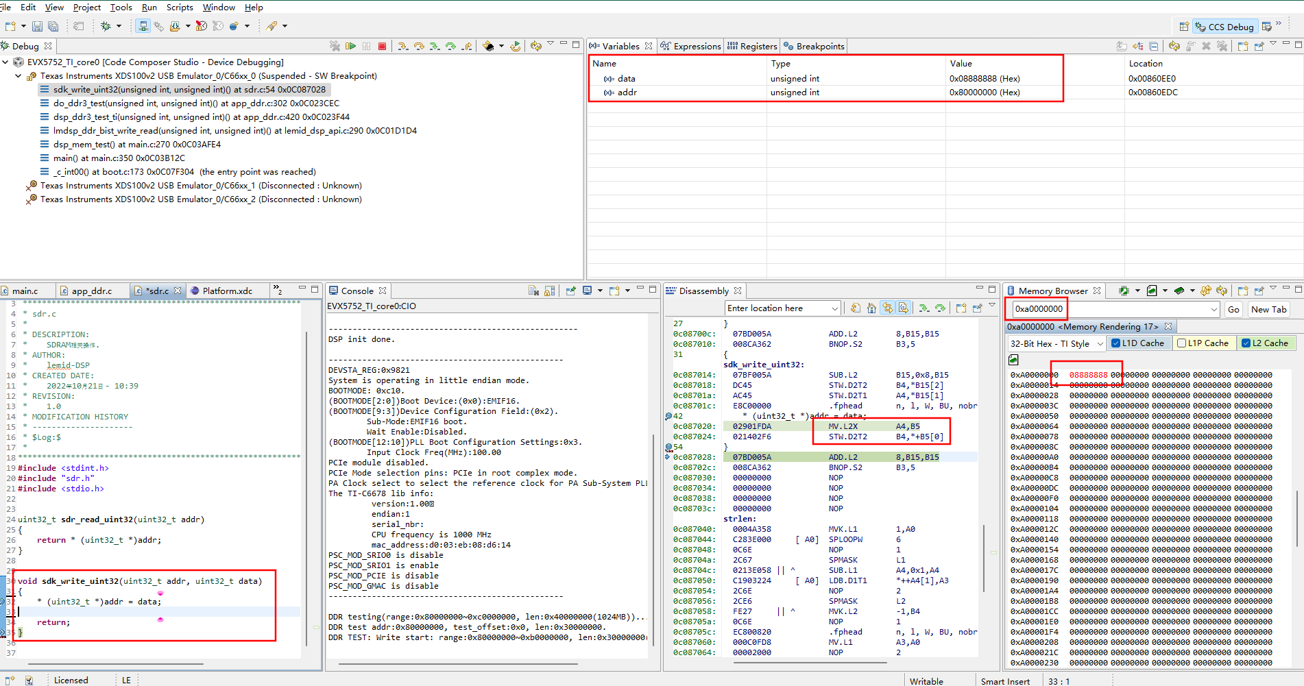

When data is written to 0x8000 0000 0x0888 8888, it is found that the contents of 0xA000 0000, 0xC000 0000, 0xE000 0000 addresses are also written as 0x0888 8888. As shown in the following figure:
I analyzed this problem as follows:
1. Through the analysis and compilation, the destination address of STW is also 0x8000 0000, not 0xA000 0000. So it doesn't feel like a logical problem with the software;

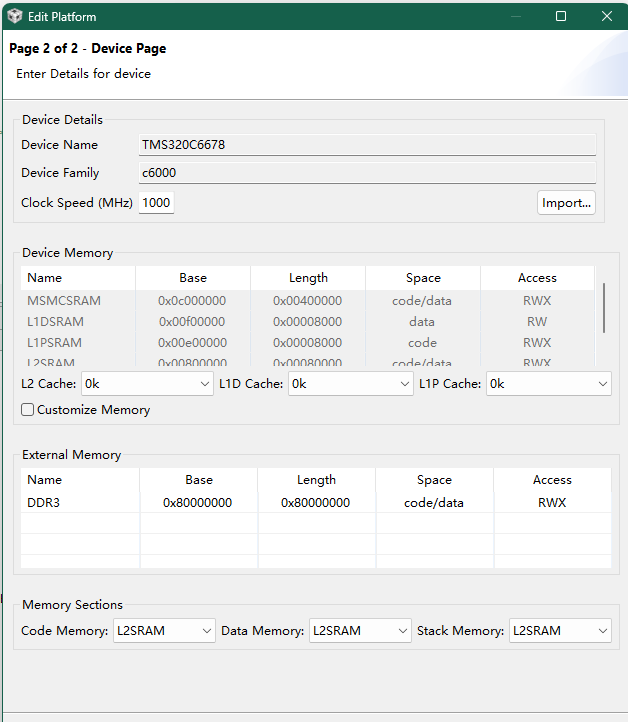

2. I also suspected that memory sharing that may be multi-core may be affected, but after setting DDR3 of External Memory in my platform to the following configuration, there is still this problem.

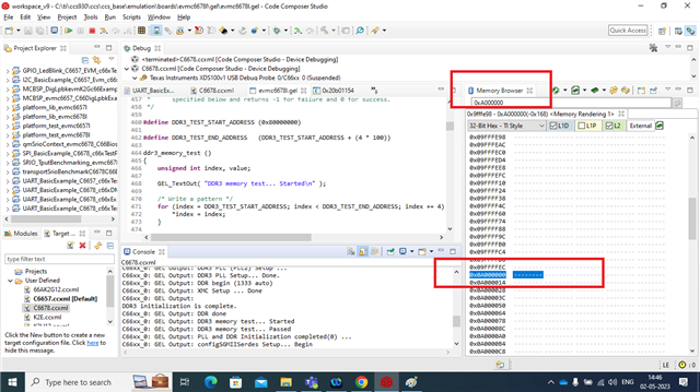

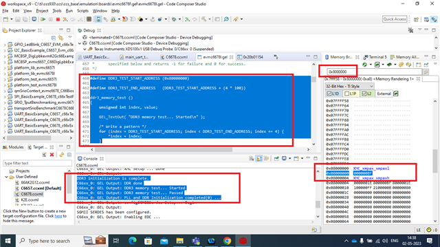

    I have experimented the same on C6678 EVM using the "evmc6678l.gel" file and rendering the outputs below.
    This gel file is located at "\ti\ccs930\ccs\ccs_base\emulation\boards\evmc6678l\gel" once you install the CCS 9.3
     *  @brief Simple DDR3 test
     *  @details
     *      This function performs a simple DDR3 test for a memory range
     *      specified below and returns -1 for failure and 0 for success.
    #define DDR3_TEST_START_ADDRESS (0x80000000)
    #define DDR3_TEST_END_ADDRESS   (DDR3_TEST_START_ADDRESS + (4 * 100))
    ddr3_memory_test ()
        unsigned int index, value;
        GEL_TextOut( "DDR3 memory test... Started\n" );
        /* Write a pattern */
        for (index = DDR3_TEST_START_ADDRESS; index < DDR3_TEST_END_ADDRESS; index += 4) {
            *index = index;
        /* Read and check the pattern */
            value = *index;
            if (value  != index) {
                GEL_TextOut( "DDR3 memory test... Failed\n" );
                return -1;
        /* Write a pattern for complementary values */
            *index = ~index;
            value = *index;
            if (value  != ~index) {
                return -1;
        GEL_TextOut( "DDR3 memory test... Passed\n" );
        return 0;
    The value at address 0X8000000 seems to be "0xBF" and the same value is not noticed at addresses "0xA000 0000", "0xC000 0000"
    Snapshot at address "0xA000000" in the memory browser

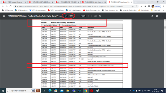

    We have to use the memory map register address appropriately...
    For example,
    08000000 0800FFFF 0 08000000 0 0800FFFF 64K  ---->    Extended memory controller (XMC) configuration
    The memory mapping address end by 0800FFFF
    where comes the addresses like 0xA000 0000, 0xC000 0000, 0xE000 0000 etc..... ????
