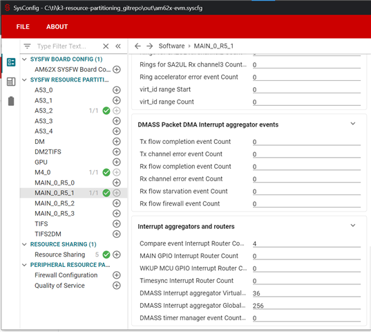

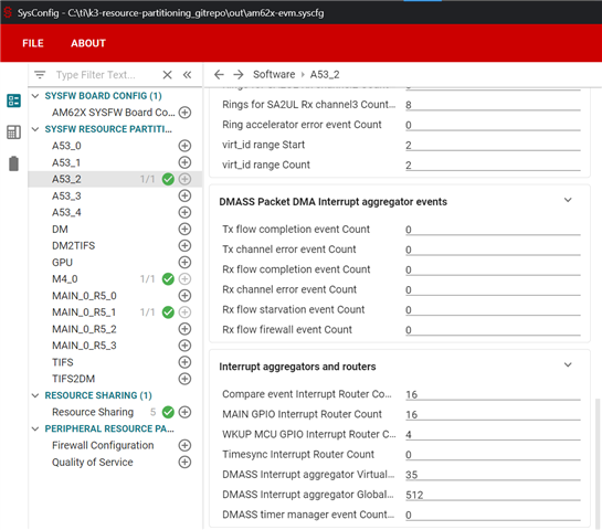

    And when I check the default Linux board config settings for AM62x, the MCU GPIO interrupts are not even allocated for R5F core.
    Here is WKUP MCU GPIO Interrupt router outputs allocated to Linux A53:
    And the same section, but with 0 outputs allocated for R5F:
    So I would not expect that Linux remoteproc driver detaching from the still-running R5F would change anything with regards to GPIO.
