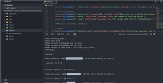

I think that my gpuand cuda is not work at first, then I try to test my GPU by a runnning a deeplearning test project:
you can see that the gpu is work well, the result seems to told me that cuda environment is available!
I want to konw how to resolve the problem, thanks!
