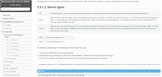

Thank you for pointing that out, I will look into that some time this week. Just read some of It and seems like that might be getting us closer to solving this. I have not had any luck finding what the red LED on the bottom indicates. Its assumed to be a fault, but of what?
Do you know who did the hardware layout on the board with the M2 tag on it, assembly # PROC100A(002). If we can verify the actual uart boot mode pin settings as stated in the TRM are correct that will help.
Per the docs
It should be send out the string to identify the device type, that does not work.

  • Hello Fred,
    Can we run a very simple board sanity check on your board?
    1/. configure SW2/SW3 as BOOTMODE[15:0]=003B for UART boot.
    2/. power on the board
    Any message from UART port?
    I'm attaching the UART log file when booting from UART on SK-AM64B (M1) for your reference.
    -Hong
