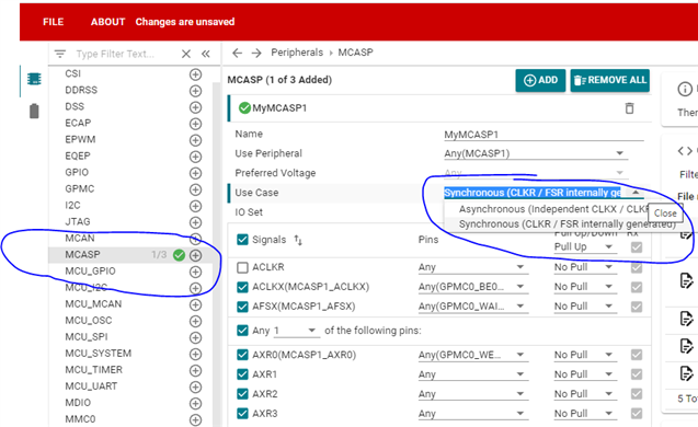

    I you asking about the pinmux (padconfig) configuration using SysConfig or configuring the SDK?
    If pinmux, can you elaborate on GPIO Multiplexer?  The SysConfig pinmux has specific McASP peripherals in the left menu and then selectable use cases.
    The above will create the following devicetree.dtsi
    /* This file was auto-generated by TI PinMux on 4/28/2023 at 8:50:44 AM. */
    /* This file should only be used as a reference. Some pins/peripherals, */
    /* depending on your use case, may need additional configuration. */
    &main_pmx0 {
    	mymcasp1_pins_default: mymcasp1-pins-default {
    		pinctrl-single,pins = <
    			AM62X_IOPAD(0x0090, PIN_INPUT, 2) /* (K17) GPMC0_BE0n_CLE.MCASP1_ACLKX */
    			AM62X_IOPAD(0x0098, PIN_INPUT, 2) /* (P21) GPMC0_WAIT0.MCASP1_AFSX */
    			AM62X_IOPAD(0x008c, PIN_INPUT, 2) /* (J17) GPMC0_WEn.MCASP1_AXR0 */

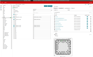

    To clarify, I am trying to use the McASP through the GPIO pins instead of through the 3.5mm jack, which seems to be the factory u-boot configuration. I was able to add a McASP device on SysConfig, but I was confused since SysConfig did not show me the other peripherals (MMC, SPI, UART, etc.) when I opened the .syscfg file provided with the EVM SDK -- is this normal? All pins appear to be unassigned when I open the .syscfg file.
    Looking at the screenshot from the post, I also don't see the "Use Case" and the "Pull Up/Down" sections on my SysConfig. I am using SysConfig version 1.16.1+2960, which seems to be the latest. I am using the Linux version on Ubuntu 18. I have the SDK version 08.06.00.42 for the AM62xx EVM, which seems to be the latest as well. You can find a screenshot of SysConfig attached, note the sections that are there on the forum post but not on my end. I am using Keystone3 Resource Partition Tool 0.5. through SysConfig.
    I am also unsure as to how SysConfig generates the .dts files. the "Generated files" section only contains .c and .h files, how can I get the u-boot configuration from these? You can see the files on the screenshot attached.
