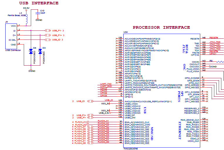

I have a board designed using C6745 which uses the USB and SPI.
I want to bring-up this board firstly with DSP/BIOS and BIOSUSB.
I have a JTAG XDS100. Please help me out with the steps.

    While we run the usbhosthid project under C:\Texas Instruments\biosusb_01_00_00\packages\ti\biosusb\examples\usbhosthid\
    we get the application stall at   dsp_bios_entry(NULL) in HostHidAppMain(void).
    There is no documents on what this API is doing and what is its dependencies. Please also help us by providing some suggestions
    Thanks ... Suresh

    Please also find the USB module of the board attached.
