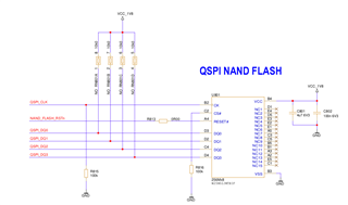

Hello Team,
we are try to communicate winbond  IC W25N02JWTBIF.
bellow is connection Image but we modify it. As-
H21---> ospi cs2
H24--->OSPI0_CLK
E25--->OSPI0_D0
G24--->OSPI0_D1
F25--->OSPI0_D2
F24--->OSPI0_D3
my DTS is:

  • Looks like you already posted the same question before, twice:
    https://e2e.ti.com/support/processors-group/processors/f/processors-forum/1206334/am625-ospi-flash-memory-of-the-evk-proc114e3-as-a-qspi-not-working/4563734#4563734
    https://e2e.ti.com/support/processors-group/processors/f/processors-forum/1205448/am625-qspi-nand-flash-not-working-with-am6254/4567381#4567381
    Both threads have "proposed answers", but then the discussion wasn't continued. One of the things flagged was the missing CS signals. The schematic extract you show above still doesn't show that connected. It won't work like this.
    Once you have confirmed/rectified the CS issue you may want to connect a logic analyzer to all the traces and compare the communication with what is expected as per TRM and Flash device datasheet.
    Regards, Andreas
  • hello Andreas,
    as i mention i remove from ground and I connected pin (H21) OSPI0_CSn2 for cs.
    but my cs pin is keep high. so please guide.

  • Hi!
    thanks for confirming the CS signal connection.
    Since you are using CS2 you'll need to update the DTS file to reflect this as follows. From this...
    &ospi0 {
        flash@0 {
            compatible = "winbond,W25N01GV","spi-nand";
            reg = <0x0>;
            spi-tx-bus-width = <1>;
            spi-rx-bus-width = <4>;
    ...to this...
    &ospi0 {
        flash@2 {
            reg = <0x2>;
    See DTS bindings description for the SPI controller for more info & an example: https://git.ti.com/cgit/ti-linux-kernel/ti-linux-kernel/tree/Documentation/devicetree/bindings/spi/spi-controller.yaml?h=ti-linux-5.10.y#n89
    Regards, Andreas

  • From the scope shots that were provided separately it looks like the CS signal was never toggling.
    So I had a closer look at this, and it looks like the spi-cadence-quadspi driver in our ti-linux-5.10.y Kernel (which is what SDK v8.x are based off) only has incomplete support for CS signals greater than 0. The support in the driver itself is there, however it is missing to correctly propagate the max number of supported CS signals to the SPI driver framework.
    Can you double-check your boot log if you see something like this?
    [    1.256882] cadence-qspi fc40000.spi: cs2 >= max 1
    If so, this would be a symptom of the concern just discussed.
    To fix this, you should cherry-pick the below commit on top of your ti-linux-5.10.y Kernel tree, and re-build/re-deploy your Kernel image.
    spi: cadence-quadspi: Add multi-chipselect support for Intel LGM SoC
    https://github.com/torvalds/linux/commit/b436fb7d29bfa48ff5e00cbf413609c7a6d4d81e
    You won't need to set the "num-cs" property explicitly in your DTS, the default (16) will work for your case.
    Also note that our upcoming TI SDK series 9.x will be based on the ti-linux-6.1.y Kernel which has the above patch already integrated.
    Regards, Andreas

  • Hi Andreas,
    We are able to detect QSPI in 8.6 version only thank you for your support.
    But If we set frq for QSPI port to 25MHz but if we measure using CRO it is 20MHz only, Can you suggest is there anything we are missing ?
  • Hi Andreas,
  • We are able to detect QSPI in 8.6 version only thank you for your support.
    Glad to hear that this is (finally) working!!
    This is Linux I suppose?
    Can you re-confirm you used the spi-max-frequency DTS property for this, in the correct SPI node?
    Then, can you please try reducing the frequency to like 10,000,000Hz to see if the actual SPI bus frequency changes to 10MHz as well (I'd like to confirm that the DTS property is indeed applied to the HW registers/peripherals at least in some scenarios).
    Regards, Andreas

  • Hi Ankit,
    can you please try the below DTS modification to set the default clock parent frequency for the OSPI module reference clock to 200MHz:
    a0797059@dasso:~/git/linux (ti-linux-6.1.y)
    $ git diff
    diff --git a/arch/arm64/boot/dts/ti/k3-am62-main.dtsi b/arch/arm64/boot/dts/ti/k3-am62-main.dtsi
    index 74e34b84419a..ab3a33bd2e1e 100644
    --- a/arch/arm64/boot/dts/ti/k3-am62-main.dtsi
    +++ b/arch/arm64/boot/dts/ti/k3-am62-main.dtsi
    @@ -680,7 +680,7 @@ ospi0: spi@fc40000 {
                            clocks = <&k3_clks 75 7>;
                            assigned-clocks = <&k3_clks 75 7>;
                            assigned-clock-parents = <&k3_clks 75 8>;
    -                       assigned-clock-rates = <166666666>;
    +                       assigned-clock-rates = <200000000>;
                            power-domains = <&k3_pds 75 TI_SCI_PD_EXCLUSIVE>;
                            #address-cells = <1>;
                            #size-cells = <0>;
    With this, the k3conf tool should now return an updated RCLK frequency as follows:
    root@am62xx-evm:~# k3conf dump clock 75
    | VERSION INFO                                                                 |
    | K3CONF | (version v0.1-90-g1dd468d built Thu Jul 13 05:45:57 PM UTC 2023)    |
    | SoC    | AM62X SR1.0                                                         |
    | SYSFW  | ABI: 3.1 (firmware version 0x0009 '9.0.5--v09.00.05 (Kool Koala))') |
    | Device ID | Clock ID | Clock Name                                                               | Status          | Clock Frequency |
    |    75     |     0    | DEV_FSS0_OSPI_0_OSPI_DQS_CLK                                             | CLK_STATE_READY | 0               |
    |    75     |     1    | DEV_FSS0_OSPI_0_OSPI_HCLK_CLK                                            | CLK_STATE_READY | 500000000       |
    |    75     |     2    | DEV_FSS0_OSPI_0_OSPI_ICLK_CLK                                            | CLK_STATE_READY | 0               |
    |    75     |     3    | DEV_FSS0_OSPI_0_OSPI_ICLK_CLK_PARENT_BOARD_0_OSPI0_DQS_OUT               | CLK_STATE_READY | 0               |
    |    75     |     4    | DEV_FSS0_OSPI_0_OSPI_ICLK_CLK_PARENT_BOARD_0_OSPI0_LBCLKO_OUT            | CLK_STATE_READY | 0               |
    |    75     |     5    | DEV_FSS0_OSPI_0_OSPI_OCLK_CLK                                            | CLK_STATE_READY | 0               |
    |    75     |     6    | DEV_FSS0_OSPI_0_OSPI_PCLK_CLK                                            | CLK_STATE_READY | 500000000       |
    |    75     |     7    | DEV_FSS0_OSPI_0_OSPI_RCLK_CLK                                            | CLK_STATE_READY | 200000000       |<-+
    |    75     |     8    | DEV_FSS0_OSPI_0_OSPI_RCLK_CLK_PARENT_HSDIV4_16FFT_MAIN_0_HSDIVOUT1_CLK   | CLK_STATE_READY | 200000000       |--+ This is now 200MHz and selected for RCLK
    |    75     |     9    | DEV_FSS0_OSPI_0_OSPI_RCLK_CLK_PARENT_POSTDIV1_16FFT_MAIN_1_HSDIVOUT5_CLK | CLK_STATE_READY | 160000000       |
    This _should_ allow for a OSPI output frequency of 25MHz if configured via spi-max-frequency using a clean integer divider. Can you please give this a try and report back (I don't have access to HW at the moment so I can't measure the actual frequency myself).
    Regards, Andreas
