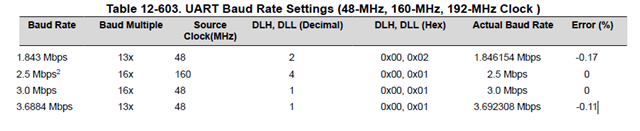

  • Hello Leon,
    Can you please confirm if you are following the below table for baudrate configuration.
    Table 12-603. UART Baud Rate Settings (48-MHz, 160-MHz, 192-MHz Clock )
    Can you provide additional details on the setup. Would you be able to share the schematics for a quick check?
    Do you see change in behavior (errors) when you increase or decrease the speed around the 3Mbps,
    Sreenivasa

    for 2.5M & 3.68M, the test was not successful as the these baud rates have a far offset on the Am64x chip and the communication was broken.
    Leon
  • correction: for 2.5Mbps, there's a far offset on AM64x chip. for 3.68M, it's not a standard rate supported by stty command so I didn't test it.

    For the 2.5M you might have to change the source clock to 160.
    Could you do a check please.

    The 2.5M would eliminate any of the concerns we may have with the baud rate division.
    Sreenivasa

    I suspect you meant the latter. In the TRM Table 12.603, 2.5Mbps is the only baud rate which uses 160MHz source clock. Now when you modified kernel device tree to set the source clock to 160MHz, adjusting baud rate from user space program will not get you the expected baud rate other than 2.5MHz. For example, when you want to set baud rate to 115200, it requires 48MHz source clock, but now kernel runs UART at 160MHz.
