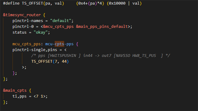

Step1: add the following to the bottom of k3-j721e-common-proc-board.dts
Step 2

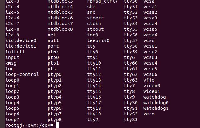

SD boot, but can not find /dev/pps0 or /dev/pps1
Questions:
1: May I know if there are anything else needs to be done to enable PPS?
