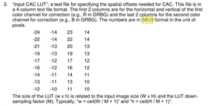

Dear TI experts,
  When we use the CAC function, we are asked to enter a four-column LUT. However, the VPAC3 help documentation does not have instructions on how to obtain LUT as in the LDC module. Also, it is unclear what the different lines in LUT represent. May I ask how we need to obtain this Lut form?  May I ask you to help me with the above problems?
