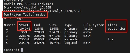

The customer is evaluating the eMMC UDA boot up, In the MBR partition mode, the AM62x evaluation board can boot up normally with fs mode, and the MBR partition format is shown below
But in GPT partition mode, EVM cannot boot up, the GPT partition format is shown below
According to the link below, GPT partition, in raw mode, ROM needs to find tiboot3.bin at a specific offset address. But in FS mode, it should not be related to the offset address (MBR partition mode can be boot normally)
boot mode pin bit3 bit7 bit9 are set to 0.
I appreciate your reply very much.
