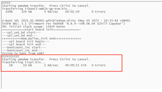

Hello, when booting through the serial port, after transferring tiboot3.bin through Xmode in the first step, the second step of transferring tispl.bin through Ymode is stuck. What should I do to troubleshoot the problem.
Hi Huan,
Can you please share the serial terminal you are using & also the steps you are following.
I am able to boot all the three binaries using Teraterm & the prebuilt binaries. I have attached below the screen recording of the successful boot using UART.
