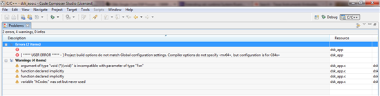

    i did that , and added the extra paths of the debug configuration into the release ,and the error has gone but 2 new errors appeared again.
    this is the error:
    "Project build options do not match Global configuration settings.  Compiler options do not specify -mv64+, but configuration is for C64x+"
    i attached the error , to have a better look
  • Ahmed,
    The image you attached is pretty small, so it's hard for me to read.  I don't see any error message for the first red X.  Do you have any additional info about that?  It looks like the 2nd red X is the message that you refer to.
    If you're using the 6455, that's a 64x+ device, and the compiler options should specify -mv6400+.  Select your project, right click and choose "Properties".  Then, under the C/C++ build menu on the left, select "Settings".  Then, in the window that comes up, under the C6000 compiler, you should select "Basic Options" and ensure that target processor version has a 6400+ in it.
