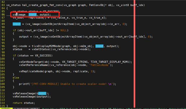

  • Hi:
        The attachment is my code of this way, 'fmt_conv' is the node of scaler and color-convert.  My graph is "capture(1920*1536) -> fmt_conv(1280*800) -> ...".  My code cannot achieve cropping functionality, The graph can run and the out _image of capture I dumped is right, But the out_image of fmt_conv I dumped is damaged and The image remains unchanged.
        Please help me check it, thank you.

    vx_status hal_create_graph_fmt_conv(vx_graph graph, FmtConvObj* obj, vx_uint8 buff_idx)
        vx_status status = VX_SUCCESS;
        vx_image  input, output;
        vx_bool   replicate[] = {vx_false_e, vx_true_e, vx_true_e};
        if (obj->in_arr[buff_idx] != NULL)
    	    input = (vx_image)vxGetObjectArrayItem((vx_object_array)obj->in_arr[buff_idx], 0);
        if (obj->out_arr[buff_idx] != NULL)
            output = (vx_image)vxGetObjectArrayItem((vx_object_array)obj->out_arr[buff_idx], 0);
        obj->node = tivxDisplayM2MNode(graph, obj->m2m_obj, input, output);
        status    = vxGetStatus((vx_reference)obj->node);
        if (status == VX_SUCCESS)
            vxSetNodeTarget(obj->node, VX_TARGET_STRING, TIVX_TARGET_DISPLAY_M2M1);
            vxSetReferenceName((vx_reference)obj->node, "FmtConvNode");
            vxReplicateNode(graph, obj->node, replicate, 3);
        else
            printf("[FMT-CONV-MODULE] Unable to create scaler node! \n");
        vxReleaseImage(&input);
        vxReleaseImage(&output);
        return status;

  • Hi Gao,
    Actually the API vxCreateImageFromROI will not be useful here. This sets additional parameters in the vx_image, which are not used in the DSS M2M node.
    The idea that Nikhil suggested above is to modify the existing DSS M2M node to accept cropping parameters as create args and then in each process API, move the start pointer of the input image into the buffer, using this crop parameters..
    I think similar approach is used in the display node. Please refer to cropPrms usage in file ti-processor-sdk-rtos-j721e-evm-08_05_00_11\tiovx\kernels_j7\hwa\display\vx_display_target.c. You would have to implement similar mechanism in file ti-processor-sdk-rtos-j721e-evm-08_05_00_11\tiovx\kernels_j7\hwa\display_m2m\vx_display_m2m_target.c.
