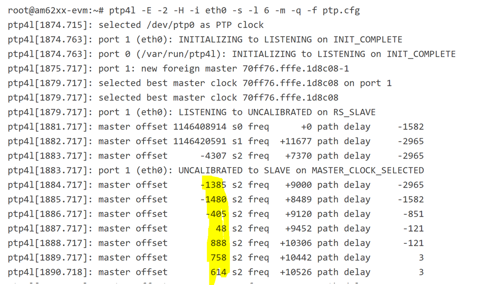

We are observing the sync deviation in nsec. Please refer to output log from below page.
https://software-dl.ti.com/jacinto7/esd/processor-sdk-linux-j721s2/08_06_01_02/exports/docs/linux/Foundational_Components/Kernel/Kernel_Drivers/Network/CPSW-PTP.html#ptp-with-ordinary-clock-mac-mode
Above highlighted text is the offset difference between ptp master and slave in nsec.
