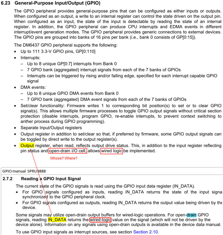

I would like to ask a question on GPIO’s open-drain characteristics.
Question 1
Are GPIO’s output buffer of DM6437 implemented using open-drain? It seems to me unlikely, since if each GPIO pin is open-drain, then there would require many additional pulling up registers on the board, which I haven’t found. Therefore, it seems to me that most (if not all) DM6437’s GPIO pins are implemented using standard output/input buffer.
However, I found seemingly contradictory description from
1.         Page 293 of sprs345d, TMS320DM6437 Digital Media Processor
2.         Page 13 of spru988b, TMS320DM643x DMP General-Purpose Input-Output (GPIO) User's Guide
(1)    Attributes wired logic to output register
(2)    Attributes wired logic to IN_DATA
I think (1) might be an error, because the result of wired logic should not be read from any output register, which holds output data, but should from any of the input registers which could read the common line (bus). So is (1) an error here or not?

    I have confirmed that the GPIO I/O within our device is not Open Drain. From design perspective, you can also use the GPIO like an open drain if you configure it as Input and use external weak pull-up.
    Best regards, Zegeye
