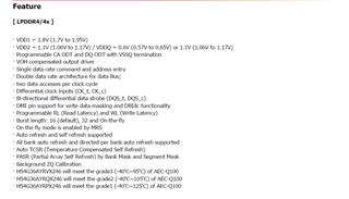

Project name: P2 ADC
SDK version: 8.05
We are investigate to use the SK DDR for P2 ADC project. The SK supplier suggest us two types DDR: H54G38AYRPX264 and H54G36AYRPX246.
But DDR supplier told us if we want to use 1CS product we have to implement/change BIOS to use BYTE mode. They think that It will be difficult to control 2 BIOS in line (other supplier vs SK Hynix BYTE Mode).
If we should use 1CS product or change to use 2CS product?  What's your ideal?
