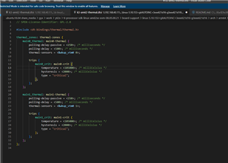

  • Test condition:
    Ta=85℃
    Test case: memtest,USB disk read & write,ethernet
    Temperature threshold was set to 105℃,When junction temp exceeds115℃,software turned off.
