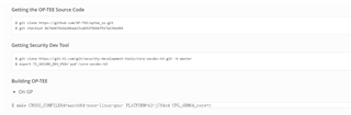

hello,
I am using TDA4VH EVM board,and i‘m using sdk8.5.

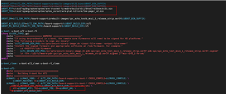

I compiled OPTEE_OS according to the method in the figure below, and got tee-pager_v2.bin。
then i make the uboot,i change the Makefile in la
 then make u-boot.
finally, i use dfu mode to verify the tiboot3.bin and tispl.bin
As a result, DFU started error,the log is below

then i change the tee as UBOOT_TEE=$(TI_SDK_PATH)/board-support/prebuilt-images/bl32.bin,The result is normal

Question
I saw that the size of the bl32.bin in the prebuilt-images and tee-pager_v2.bin compiled by myself was exactly the same. I want to ask where it was wrong.
best regards!
    The compilation command that you are using to compile OPTEE is incomplete & that is the case with SDK documentation as well.
    Please use the below command:
    $ make CROSS_COMPILE64=aarch64-none-linux-gnu- PLATFORM=k3-j784s4 CFG_ARM64_core=y CFG_CONSOLE_UART=0x8
    Or Try exporting:
    $ export CFG_CONSOLE_UART=0x8
    I have raise an internal bug to fix the documentation.
