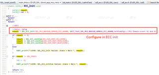

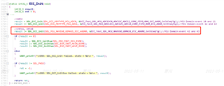

TI EXPERT said that "The INTA1 diagnostic can be tested by performing the ECC test on NAVSS MODSS Aggr (SDL_NAVSS0_MODSS_ECC_AGGR0), NAVSS UDMASS Aggr (SDL_NAVSS0_UDMASS_ECC_AGGR0) and MCU NAVSS UDMASS Aggr (SDL_MCU_NAVSS0_UDMASS_ECC_AGGR0)."
Now I did it as below shows, but found that the ESM will work, and my software was continuously reset by PMIC.
I have three questions about this phenomenon:
1.My board is new, why this ECC error happened?
2.When ESM detects the ECC error, how to repair this error?
3.Why the reset is contious, not only once? Is that mean if an ESM error detected, my software will always reset contiously and can't run normally again?
    Is the ECC error triggered only after injecting or does the error occur immediately on ECC init?

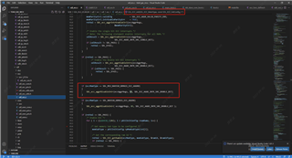

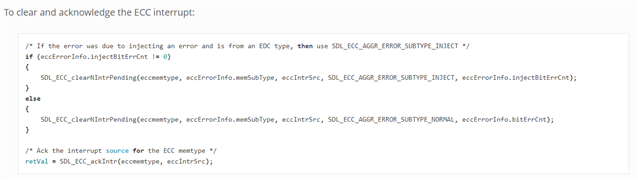

    The ESM error event needs to be cleared. SDL ESM module takes care of clearing the ESM error as part of handling the interrupt, but the application’s ESM handler callback has to take care to clear the ECC error event.
    Please refer to the "to clear and acknowledge the ECC interrupt” section in the user guide for guidance: 4.2. ECC : Error Correcting Code — Software Diagnostics Library (SDL) - J721E User Guide. This has also been implemented in the SDL ECC example in the ecc_main.c source code.
    ECC and ESM cannot reset the board. If PMIC is resetting it, then it may be that PMIC is monitoring the ESM error pin and then resetting if the error pin is not cleared or if the watchdog timer is enabled.Could you please share the logs obtained when the reset occurs?
    The application needs to take care of clearing the error pin after processing an ESM error to indicate that the error has been handled by SW (if it was able to handle it) so that an external monitor won’t take action on it. Clearing of the error pin is mentioned in the example usage of ESM: 4.1. ESM : Error Signalling Module — Software Diagnostics Library (SDL) - J721E User Guide

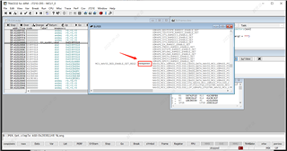

    The ECC error occured immediately after ECC init:

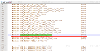

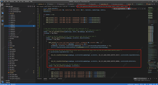

    I have configured the MCU ESM event for SDL_MCU_NAVSS0_UDMASS_ECC_AGGR0:

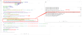

    In  ESM handler callback I clear the ECC error and error pin:
    And PMIC ESM function also configure to START:
    But the log showed that my software still reset continously by PMIC:

    Please help to give any suggestion to make sure that the SW reset only once when an ESM error detected and run normally in the next cycle(not reset continously), thanks!
    Is the SW reset by PMIC expected to occur in your test case scenario? Could you provide a flow of what you are expecting?
    Josiitaa
  • I expected that when INTA1 diagnostic error detected, it could be repaired in ESM handler callback and meanwhile reset by PMIC, then in next cycle this error won't happen again after ECC init because has already been repaired  in last cycle. Expected that the SW was not reset once by once. Thanks.
    Is the application injecting the error in each cycle? If so, when the SW reset occurs, the error will be detected and the ESM callback triggered. This will cause another reset.
    Josiitaa
  • Is the ECC error triggered only after injecting or does the error occur immediately on ECC init?
    The ECC error is not injected manually , just triggred on ECC init in each cycle.
    Im not sure that I understand how the error is being triggered in your use case. Are you performing any other tests before that might trigger the error? Could you use the debugger to check which error bit has been set when you run the ECC init function?
    Josiitaa
  • Hi, I didn't perform any other tests before the error triggered by ECC init. As the print log showed, ESM handler callback was triggered by error bit 90, i.e.SDL_MCU_NAVSS0_UDMASS_ECC_AGGR0.
    So there is no error injection performed, but the error bit is being set? Could you connect a debugger and read the value of the SDL_MCU_NAVSS0_UDMASS_ECC_AGGR0 and check if any other bits in the offset registers have been modified? I'm trying to understand which error event has occurred.
    Josiitaa
  • So there is no error injection performed, but the error bit is being set?
    Yes.
    I am not sure which value you wanted to watch, Could you get anything useful in the print log showed below?
    It looks like the bit may be set even before ECC init. Could you connect a debugger to see when exactly the bit is being set? Dump the memory of SDL_MCU_NAVSS0_UDMASS_ECC_AGGR0 at 0x28381000 and step through the code to see when the bit is being set.
    Josiitaa
  • Hi Josiitaa,
    It can be read related register valude. Do you have any other better idea to debug it?
    Could you let me know exactly during which the bit is being set? If not, the only way to move ahead would be to clear the ESM error and move ahead.
    Josiitaa
  • hi, josiitaa:
    Same case, after initializing the ECC function of the MCU_NAVSS0_UDMASS module, bit16 at address 0x283811148 is set to 1 immediately,  and ESM interrupt is triggered,NAVSS0_UDMASS has same bug:
    Catching up on this thread, thank you for sharing the bits of concern.
    Wanted to check if the bits when set, can be cleared as documented in errata i2191 workaround, prior to enabling the ECC aggregator.
    The steps to follow to clear bits are in the SDL ECC documentation:
    Look for the section about “to clear and acknowledge the ECC interrupt”
    Additionally, depending on the ESM configuration, the ESM error pin, may need to be cleared as well.
    Look for the section “If an error pin is asserted…”
    kb
  • Hi, KB:
    i has cleared and acked the ecc interrupt in application callback function:
    but  after exiting the interrupt, bit16 is immediately set again,the interrupt keeps trigering:
    According to the i2191 solution, can only mask the corresponding interrupt?
    Are you running some usecase that could be continually triggering the situation that causes the errata (and the ECC event)? This would be something like a DMA transfer ongoing. If this is the case and your usecase involves running some DMA that will keep triggering the errata, then we will have to suggest that you disable the endpoint entirely. Could you provide information on what is being run when this error is observed so that we can rule this out?
    Josiitaa

    Can you try clearing the error event in the registers before calling the SDL_ECC_init()?
    You will need to check to see what the bit error count is, then call:
    SDL_ECC_clearNIntrPending(SDL_MCU_NAVSS0_UDMASS_ECC_AGGR0, 80, SDL_ECC_AGGR_INTR_SRC_DOUBLE_BIT, SDL_ECC_AGGR_ERROR_SUBTYPE_NORMAL, <bit error count>);
    SDL_ECC_ackIntr(SDL_MCU_NAVSS0_UDMASS_ECC_AGGR0, SDL_ECC_AGGR_INTR_SRC_DOUBLE_BIT);
    Josiitaa
  • hi, josiitaa:
    after testing, the operation that clearing the error event in the registers before calling the SDL_ECC_init() is useless

    Can you try this in SDL_ECC_init were you were trying to mask the event to see if this prevents the interrupt from happening:
    1. Comment out the calls to SDL_ecc_aggrEnableIntrs()
      1. This will prevent the event interrupt from being enabled even for a short period of time
    2. Before the call to SDL_ECC_getAggregatorType(), add calls to SDL_ecc_aggrEnableIntr for SEC and DED:
      1. SDL_ecc_aggrEnableIntr(eccAggrRegs, ramId, SDL_ECC_AGGR_INTR_SRC_SINGLE_BIT);
      2. SDL_ecc_aggrEnableIntr(eccAggrRegs, ramId, SDL_ECC_AGGR_INTR_SRC_DOUBLE_BIT);
    3. In the configuration structure with the list of endpoints (pMemSubTypeList) that the application passes to the SDL_ECC_init call, remove the endpoint which you want to disable.
    This should prevent the endpoint’s interrupt from ever getting enabled, even for a short period.
    Josiitaa
