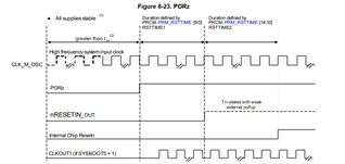

One question that we have concerns the SYSBOOT latching sequence. In numerous sections of the reference manual, it is stated that the “final” SYSBOOT values are latched at the last rising edge of the PWRONRSTn. However, we can read the following in section 8.1.7.3.2 of the technical reference manual:
“PORz pin at chip boundary gets asserted (goes low). Note: The state of nRESETIN_OUT during PORz assertion should be a don’t care, it should not affect PORz (only implication is if they are both asserted and nRESETIN_OUT is deasserted after PORz you will get re-latching of boot config pins and may see warm nRESETIN_OUT flag set in PRCM versus POR).”

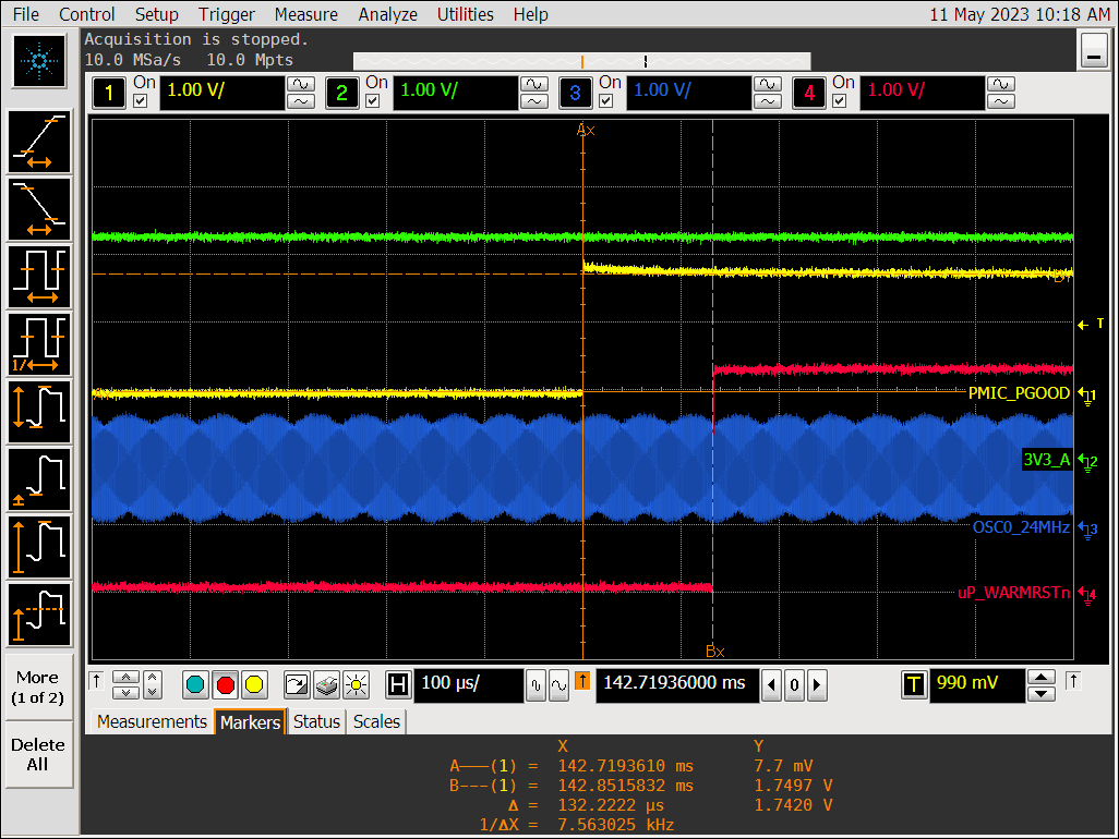

Could you please provide some explanation concerning the highlighted text? From what we can see in the timing diagram of figure 8.23, it seems to be a standard behavior to have the nRESETIN_OUT (WARMRSTn external pin) de-asserted after the PORz (PWRONRSTn external pin):
We can also observe this sort of timing on one of our working units:
Could you please help us understand the re-latching condition mentioned in the reference manual (listed above) and provide any other information/questions that could help us investigate this issue further?

    I think the highlighted text is just referring to the instance where both POR and nRESET_INOUT are both asserted.  In this case, the boot pins will get relatched since PORz was toggled.  If you are just toggling nRESET_INOUT, then the boot pins will not get relatched, and the original boot order should occur.
    One thing i can think of is that these failing units may be possibly getting a inadvertent POR asserted, which may be latching in a bad SYSBOOT value.  In this case, your suspicion would be correct since a WARTRST would attempt to boot from a source that was not intended.  To test this on a failing unit, you can probe some signals to see if the ROM is executing.  I'm not sure what your boot list is, but for example, you can check to see if CS is toggling if you are booting from NAND, or check a clock signal on a boot interface that uses a clock.  Which boot sequence are you using?
