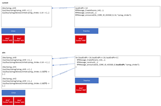

Regarding the target application I would like to open 3 endpoints on the R5Fss0_0 to have three channels to exchange data with Linux.
Find the attached concept for further clarification. The for loop at the right hand side should only show the principle .. ;)
When the first endpoint is created and annouced to linux by R5F, the linux console prints following message, saying endpoint (channel) 14 is available:
[timestamp] virtio_rpmsg_bus virtio0: creating channel rpmsg_chrdev addr 0xe
The rpmsg device is created under /dev/rpmsg_ctrl0. Also the following (corresponding) symlinks are created:
/sys/class/rpmsg/rpmsg_ctrl0 -> ../../devices/platform/bus@f4000/bus@f4000:r5fss@78000000/78000000.r5f/remoteproc/remoteproc1/remoteproc1#vdev0buffer/virtio0/virtio0.rpmsg_chrdev.-1.14/rpmsg/rpmsg_ctrl
and
sys/bus/rpmsg/devices/virtio0.rpmsg_chrdev.-1.14 -> ../../../devices/platform/bus@f4000/bus@f4000:r5fss@78000000/78000000.r5f/remoteproc/remoteproc1/remoteproc1#vdev0buffer/virtio0/virtio0.rpmsg_chrdev.-1.14
When the second RPMessage_announce is executed no message is printed to the console saying a new channel is created.
I can announce the second Endpoint alone,when no other endpoint is announced before, but not as the second one.
Can anyone help me how to manage my problem?
Is it even possible to open 3 endpoints of the same kind from the same core (R5Fss0_0), all using the rpmsg-char driver?
How do I get more rpmsg devices, e.g. rpmsg_crtl1 and rpmsg_ctrl2?
Is the service Name "rpmsg_chrdev" fixed for all three endpoints?
As you may have noticed during reading not all definitions are clear to me, e.g. Channel, driver (ti-rpmsg-char), module (rpmsg_char)...
Can these definitions be matched to the created symlinks?

    Sorry my explanation was not clear. It is possible to create and announce Endpoint with numbers 14 and 15 individually. But when I create Endpoint with number 15 and announce it to Linux after Endpoint 14 was successfully created and announced (and its device /dev/rpmsg_ctrl0 was added in Linux), nothing happens. No message about endpoint number 15 is shown on the Linux console as before in the individual case. Also no device /dev/rpmsg_ctrl1 is added.
    See attached figure for further clarification.
    Do you have any more suggestions for me? Am I doing something wrong?

  • So I have some results:
    When the binary for the R5f is loaded by linux during the boot process it shows that all the 3 desired channels are created:
    [   15.881572] virtio_rpmsg_bus virtio0: creating channel ti.ipc4.ping-pong addr 0xd
    [   15.881837] virtio_rpmsg_bus virtio0: creating channel rpmsg_chrdev addr 0xe
    [   15.881979] virtio_rpmsg_bus virtio0: creating channel rpmsg_chrdev2 addr 0xf
    [   15.882093] virtio_rpmsg_bus virtio0: creating channel rpmsg_chrdev3 addr 0x10
    [   15.950668] virtio_rpmsg_bus virtio0: rpmsg host is online

    Testing the program by using the corresponding rpmsg_char_simple app shows that the first endpoint works well, but the second and third do not:
    First (rpmsg_chrdev, Endpt number 14):
    root@-target-:/home/-user-/ti-example-multiple-channels# ./rpmsg_char_simple -r 2 -n 10 -d rpmsg_chrdev -p 14
    Created endpt device rpmsg-char-2-849, fd = 3 port = 1025
    Exchanging 10 messages with rpmsg device ti.ipc4.ping-pong on rproc id 2 ...
    Sending message from Linux #0: hello there 0!
    Receiving message echoed by R5F #0: hello there 0!
    Sending message from Linux #1: hello there 1!
    Receiving message echoed by R5F #1: hello there 1!
    Sending message from Linux #2: hello there 2!
    Receiving message echoed by R5F #2: hello there 2!
    Sending message from Linux #3: hello there 3!
    Receiving message echoed by R5F #3: hello there 3!
    Sending message from Linux #4: hello there 4!
    Receiving message echoed by R5F #4: hello there 4!
    Sending message from Linux #5: hello there 5!
    Receiving message echoed by R5F #5: hello there 5!
    Sending message from Linux #6: hello there 6!
    Receiving message echoed by R5F #6: hello there 6!
    Sending message from Linux #7: hello there 7!
    Receiving message echoed by R5F #7: hello there 7!
    Sending message from Linux #8: hello there 8!
    Receiving message echoed by R5F #8: hello there 8!
    Sending message from Linux #9: hello there 9!
    Receiving message echoed by R5F #9: hello there 9!
    Communicated 10 messages successfully on rpmsg-char-2-849
    TEST STATUS: PASSED
    Second (rpmsg_chrdev2, Endpt number 15):
    root@-target-:/home/-user-/ti-example-multiple-channels# ./rpmsg_char_simple -r 2 -n 10 -d rpmsg_chrdev2 -p 15
    _rpmsg_char_find_ctrldev: rpmsg directory doesn't exist under virtio0.rpmsg_chrdev2.-1.15
    Can't create an endpoint device: No such file or directory
    TEST STATUS: FAILED
    Third (rpmsg_chrdev3, Endpt number 16):
    root@-target-:/home/-user-/ti-example-multiple-channels# ./rpmsg_char_simple -r 2 -n 10 -d rpmsg_chrdev3 -p 16
    _rpmsg_char_find_ctrldev: rpmsg directory doesn't exist under virtio0.rpmsg_chrdev3.-1.16
    TEST STATUS: FAILED
    I searched in the rootfs for further infomation. In the remoteproc section for the core are all endpoints listed:
    root@-target-:/home/-user-/ti-example-multiple-channels# ls -l /sys/class/remoteproc/remoteproc1/remoteproc1#vdev0buffer/virtio0/
    total 0
    -r--r--r-- 1 root root 4096 Aug  7 16:14 device
    lrwxrwxrwx 1 root root    0 Aug  7 16:14 driver -> ../../../../../../../../../bus/virtio/drivers/virtio_rpmsg_bus
    -r--r--r-- 1 root root 4096 Aug  7 16:14 features
    -r--r--r-- 1 root root 4096 Aug  7 16:14 modalias
    drwxr-xr-x 2 root root    0 Aug  7 16:14 power
    -r--r--r-- 1 root root 4096 Aug  7 16:14 status
    lrwxrwxrwx 1 root root    0 Aug  7 13:25 subsystem -> ../../../../../../../../../bus/virtio
    -rw-r--r-- 1 root root 4096 Aug  7 13:25 uevent
    -r--r--r-- 1 root root 4096 Aug  7 16:14 vendor
    drwxr-xr-x 4 root root    0 Aug  7 13:25 virtio0.rpmsg_chrdev.-1.14
    drwxr-xr-x 3 root root    0 Aug  7 13:25 virtio0.rpmsg_chrdev2.-1.15
    drwxr-xr-x 3 root root    0 Aug  7 13:25 virtio0.rpmsg_chrdev3.-1.16
    drwxr-xr-x 3 root root    0 Aug  7 13:25 virtio0.ti.ipc4.ping-pong.-1.13
    The links to this endpoints are also all created under /sys/bus/rpmsg/devices:
    root@-target-:/home/-user-/ti-example-multiple-channels# ls -l /sys/bus/rpmsg/devices/
    total 0
    lrwxrwxrwx 1 root root 0 Aug  7 14:33 virtio0.rpmsg_chrdev.-1.14 -> ../../../devices/platform/bus@f4000/bus@f4000:r5fss@78000000/78000000.r5f/remoteproc/remoteproc1/remoteproc1#vdev0buffer/virtio0/virtio0.rpmsg_chrdev.-1.14
    lrwxrwxrwx 1 root root 0 Aug  7 14:33 virtio0.rpmsg_chrdev2.-1.15 -> ../../../devices/platform/bus@f4000/bus@f4000:r5fss@78000000/78000000.r5f/remoteproc/remoteproc1/remoteproc1#vdev0buffer/virtio0/virtio0.rpmsg_chrdev2.-1.15
    lrwxrwxrwx 1 root root 0 Aug  7 14:33 virtio0.rpmsg_chrdev3.-1.16 -> ../../../devices/platform/bus@f4000/bus@f4000:r5fss@78000000/78000000.r5f/remoteproc/remoteproc1/remoteproc1#vdev0buffer/virtio0/virtio0.rpmsg_chrdev3.-1.16
    lrwxrwxrwx 1 root root 0 Aug  7 13:25 virtio0.ti.ipc4.ping-pong.-1.13 -> ../../../devices/platform/bus@f4000/bus@f4000:r5fss@78000000/78000000.r5f/remoteproc/remoteproc1/remoteproc1#vdev0buffer/virtio0/virtio0.ti.ipc4.ping-pong.-1.13
    Nevertheless there is only one rpmsg device created (rpmsg_ctrl0) which points to the first created endpoint with number 14:
    root@-target-:/home/-user-/ti-example-multiple-channels# ls -l /dev/rpmsg*
    crw------- 1 root root 239, 0 Aug  7 13:25 /dev/rpmsg_ctrl0
    root@-target-:/home/-user-/ti-example-multiple-channels# ls -l /sys/class/rpmsg/
    total 0
    lrwxrwxrwx 1 root root 0 Aug  7 13:39 rpmsg_ctrl0 -> ../../devices/platform/bus@f4000/bus@f4000:r5fss@78000000/78000000.r5f/remoteproc/remoteproc1/remoteproc1#vdev0buffer/virtio0/virtio0.rpmsg_chrdev.-1.14/rpmsg/rpmsg_ctrl0
    So I believe these deveices must be created to work correctly, do they?
    Compared to my own project it can be seen that you are using diffenrent service names for the endpoints (rpmsg_chrdev<2|3>) while I was using the same name  rpmsg_chrdev for both (Have to change this of course).
    Also it uses different freeRTOS Task while I am using one single task, which calls the subprogramms dealing with the endpoints cyclically.
    Have you some more ideas regarding the sample program? Again thank you for your effort!

  • Actually, I got a weekend update from the Linux developer! Can I get you to retry, but giving all the endpoints the same service name of rpmsg_chrdev?
    From the developer:
    The service name needs to be 'rpmsg_chrdev' and it can have multiple endpoints. I believe, AM62A and J7 vision apps use multiple endpoints. The virtio sysfs listing in your thread above looks fine. but since there is no 'rpmsg-chrdev2' rpmsg device driver, you do not see /dev/rpmsg' char device nodes.
    Nick

  • Hello Nick,
    I have positive feedback for you and your team!
    We can now talk to all the Endpoints with service name rpmsg_chrdev on R5fss0_0!

    Compared to the previous example all three character devices are created ...
    root@-target-:/home/-user-/ti-example-multiple-channels# ls -l /dev/rpmsg_ctrl*
    crw------- 1 root root 239, 1 Aug  7 13:25 /dev/rpmsg_ctrl1
    crw------- 1 root root 239, 2 Aug  7 13:25 /dev/rpmsg_ctrl2
    ... and linked to the corresponding buffers:

    From now on I would say it is my part to port this working example into my project.
    I will document the differenties found and will let you know here about the results (As written above I already tried the same rpmsg_chrdev name for all endpoints, which did not work. Perhaps it has something to do with the different/individual freeRTOS tasks..).
    Many thanks for your help so far! When I was successful I will mark these thread as solved of course.
    Have a nice week and best regards,
    Daniel

  • Hi Nick,
    I was lucky at the first shot!
    Comparing your example and my project I saw following difference:
    In the example all three endpoints were created first [RPMessage_CreateParams_init( ... ), RPMessage_construct( ... ) ].
    After that all endpoints are announced to Linux one after the other by calling RPMessage_announce( ... ).
    In my project I was calling all three functions [RPMessage_CreateParams_init( ... ), RPMessage_construct( ... ) and RPMessage_announce( ... )] right after each other and then doing all three functions again for the next endpoint.
    It seems it is not possible to created (and announce) an endpoint, when one endpoint was already announced before.
    Maybe there is a reason for that?
    So for know from my side it looks like it has nothing to do with the "different tasks required for each endpoint" guess.
    Daniel
  • Hello Daniel,
    The MCU+ developer said that you do need a separate task for each endpoint. From our conversation:
    We need a seperate RPMessage_Object for each local end point. Each object will have different semaphore. Receive has to wait on a semaphore to be posted from ISR. So we need a separate task for waiting on each semaphore.
    That is an unexpected observation! I would have assumed that order of operations does not matter. I am checking with the developer to see if that is expected.
    Nick
