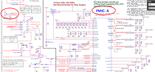

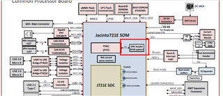

Hi, Expert,
As title description.
What's the function of  "3 pin header (NVM Update)"  on J721ESOM PMIC block
This question is come from customer, I guess it should be debug purpose only.
If you want to control PMIC by extra MCU, we can use this "3 pin header" for I2C control, Am I right?
This question is just a double check.
Many Thanks
Gibbs
       The function is to provide I2C access to the PMIC from an external microcontroller.  Typically this is done with the TPS6594-Q1 EVM and the intent is for debug.  There is no functional or application need.
