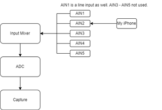

  • Hello Suren,
    The routing is if I am not mistaken from wm8776.c:
    When checking the DAPM via debugfs everything seems to be fine.
    root@debian-armhf:/sys/kernel/debug/asoc/audio card/wm8776.0-001b/dapm# cat ./AIN2 && cat ./'Input Mixer' && cat ./ADC && cat ./Capture
    AIN2: On  in 1 out 1
     out  "AIN2 Switch" "Input Mixer"
    Input Mixer: On  in 1 out 1 - R13(0xd) mask 0x40
     out  "static" "ADC"
     in  "AIN2 Switch" "AIN2"
    ADC: On  in 1 out 1 - R13(0xd) mask 0x2
     stream Capture inactive
     out  "static" "Capture"
     in  "static" "Input Mixer"
    Capture: On  in 1 out 1
     stream Capture active
     out  "static" "IIS Capture"
     in  "static" "ADC"
    The only thing I am unsure about is the inactive capture on the ADC. But even when the ADC is enabled I would expect some sounds from the ADC.
    Kind regards,
    Lars
