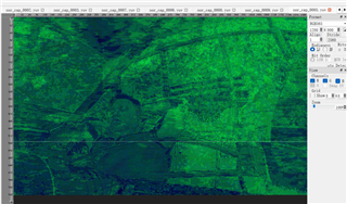

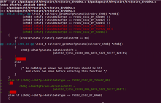

I am adding an X1F camera on the TDA4VH platform, and the camera output is in uyvy422 format
Required support
1) Do you have a demo code of capturing images in the uyvy422 format?
Could you provide me with a reference? Existing code includes single_ cam_ The app is implemented to capture raw format.

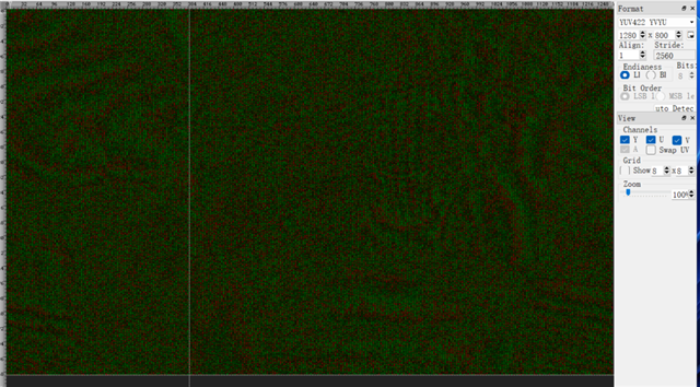

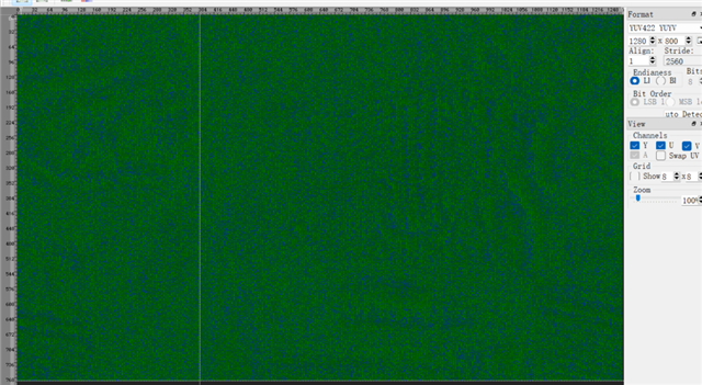

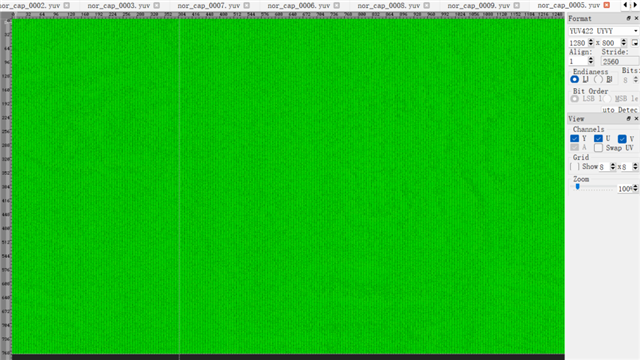

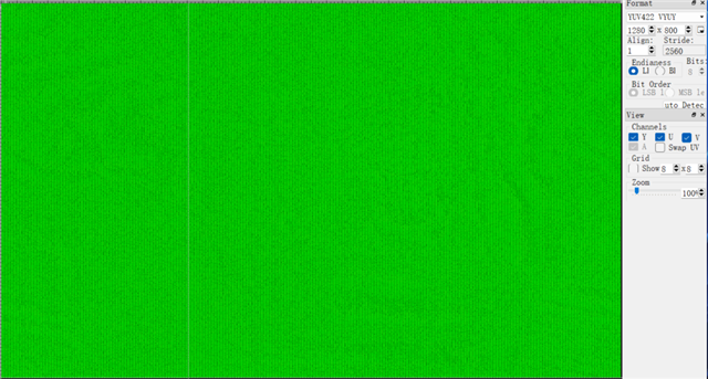

2) Currently, I have written a screenshot testing program myself, but I have found that
a) The captured image is opened in uyvy422 format and presents a dark green image, but the image cannot be seen
b) If opened it with rgb565 format, I can see blurry patterns inside, but the camera is outputting uyvy422. We suspect that there is a problem with the test case or saved data. Please help support it
