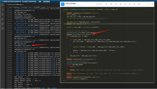

Issue: Inference thread crashes during the model inference process.
We suspect that it may be due to insufficient resources, but no effective logs have been observed.
Details:
The CPU usage remains consistently high (97%), and we are working on optimization.
The shared memory usage is approximately 80MB, which should be within the configured limit of 512MB.
The average memory bandwidth is around 5.5GB/s with a peak of 104GB/s.
Hardware: tda4vm
ti_sdk Version: ti sdk 8.4

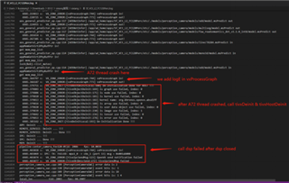

Trigger Condition: Simultaneous inference of 7 models using 4 threads, with one of the models being larger. If we remove this largest model, we haven't encountered any crashes for now.
By adding logs in the tiovx source code, we have identified the crash location as follows. During multiple tests, the crashes occur between 10 to 90 minutes, and the crash position remains consistent.

  • We run 7 models in 4 threads
    got crash callstack as follow(with gdb), running on A72 core
    log is attached below
    Thread 23 "ActorThread_2" received signal SIGSEGV, Segmentation fault.
    [Switching to Thread 0xfee865caec00 (LWP 1298)]
    0x0000fee8820a48e4 in appMemGetVirt2PhyBufPtr () from /app/ad_home/lib/libvx_tidl_sdk.so
    (gdb) bt
    #0  0x0000fee8820a48e4 in appMemGetVirt2PhyBufPtr () from /app/ad_home/lib/libvx_tidl_sdk.so
    #1  0x0000fee8805398b4 in MindSporeA::ti::TivxAllocator::TivxMemHost2SharedPtr(void*) () from /usr/lib64/libmindspore-a.so
    #2  0x0000fee880470efc in MindSporeA::ti::TiNode::Run(std::__1::vector<mindspore::MSTensor, std::__1::allocator<mindspore::MSTensor> > const&, std::__1::vector<mindspore::MSTensor, std::__1::allocator<mindspore::MSTensor> >&) () from /usr/lib64/libtda4_hal.so
    #3  0x0000fee8805d3238 in MindSporeA::TiProcessor::Run(std::__1::vector<mindspore::MSTensor, std::__1::allocator<mindspore::MSTensor> > const&, std::__1::vector<mindspore::MSTensor, std::__1::allocator<mindspore::MSTensor> >&) const () from /usr/lib64/libti-plugin.so
    #4  0x0000fee8805d0298 in MindSporeA::TiCustomKernel::Execute() () from /usr/lib64/libti-plugin.so
    #5  0x0000fee87f98d9cc in mindspore::kernel::KernelExec::DoExecute() () from /usr/lib64/libmindspore-lite.so
    #6  0x0000fee87f98ded0 in ?? () from /usr/lib64/libmindspore-lite.so
    #7  0x0000fee87f99bad4 in mindspore::kernel::CustomSubGraph::Execute(std::__1::function<bool (std::__1::vector<mindspore::lite::Tensor*, std::__1::allocator<mindspore::lite::Tensor*> >, std::__1::vector<mindspore::lite::Tensor*, std::__1::allocator<mindspore::lite::Tensor*> >, mindspore::MSCallBackParam const&)> const&, std::__1::function<bool (std::__1::vector<mindspore::lite::Tensor*, std::__1::allocator<minds
