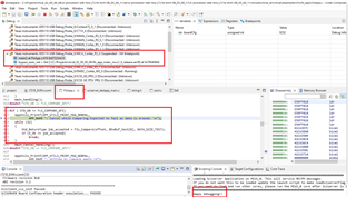

    I tried to execute all the mentioned steps above but still we are not able to see fls initialization clearly and the shared executable always stops at abort fucntion.
    Please find the screenshot the CCS image. where even CPU reset and loading into R5 Core is executed.

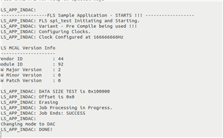

    Are you seeing prints on MCU UART as below ?
    fls_app_indac_mcu1_0_release.xer5f'
    I took the same executable shared to you and running at my end ,
    i got the above prints and exited.

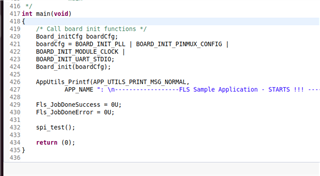

    The source code FlsApp.c in the screenshot you shared is not of INDAC mode .
    In INDAC mode FlsApp.c line 418 we can see
    Are you opening it manually or after loading the executable FlsApp.c is getting opened ?
