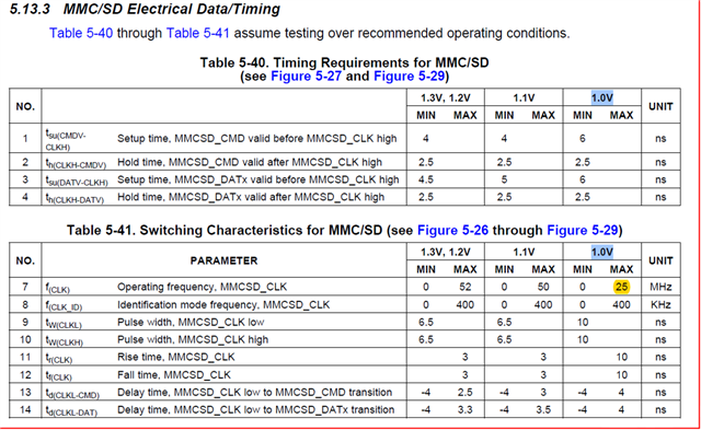

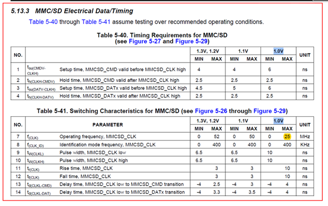

    Please refer below and confirm the peripherals you are using are supported at the programmed voltage.
    Some interfaces have specific limitations on supported modes/speeds at each operating point. See the corresponding peripheral sections of this document for more information.

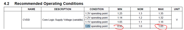

  • Hi ,
          I have tried the following changes:
          1. The CVDD voltage measured is 1.00V, and last night, I also tried 1.06V. The I2C will also timeout when CVDD=1.06V.
          2. The I/O bank of the I2C is 3.30V, and the pullup resistor is 4.7K.(I also tried 2.2K and 10K, nothing changed.)
              In fact, the CVDD should have nothing related with the I2C voltage.
          3. I set down the I2C freq from 400kHz to 100kHz, nothing changed.
              Accroding to the following datasheet, the I2C speed has nothing related with the CVDD.
              I have checked all the peripherals, the I2C/SPI/eMMC, but I think nothing violates the datasheet.
    Frank

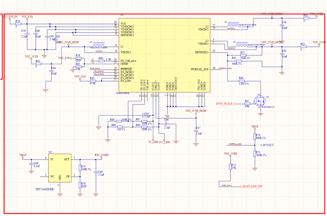

  • Hi ,
        I will try 1.1V right away.
        Yes, it's a custom board. The power supply is shown below, with BQ650250, which supply 3.3V/1.8V, and now R57/R61/R64 is adjusted to supply 1.2V/1.0V for CVDD. And also the 1.2V LDO output is supplied to the USB and RVDD.
    Frank

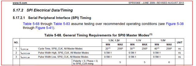

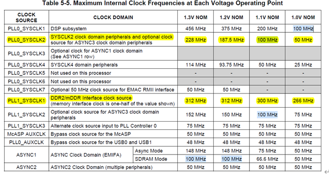

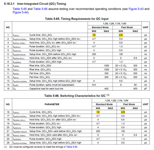

         I have done peripherial speed review for the 2nd time, which is shown below. There is no speed violation.
    Pepriphral Speed Review
    Peripherial
    1.0V Limitation according to datasheet
    Speed in my system
    CPU
    100MHz
    80MHz
    DDR2
    266MHz
    80MHz
    eMMC
    25MHz
    Set by pdk driver, I don’t know the speed. But files are written/read normally.
    SPI0
    Master 25MHz
    4MHz
    SPI1
    Slave  16.67MHz
    1.8MHz
    I2C0
    400kHz
    100kHz
    I2C1
    400kHz
    100kHzcan not work normally
    GPIO
    CPU/DDR
    eMMC <=25MHz
    SPI <=25MHz
    Master40ns25MHz
    Slave60ns16.67MHz
    I2C <=400Hz
    JTAG <=15MHz
    1.0V Range
        Is there any other possibilities?
    Frank

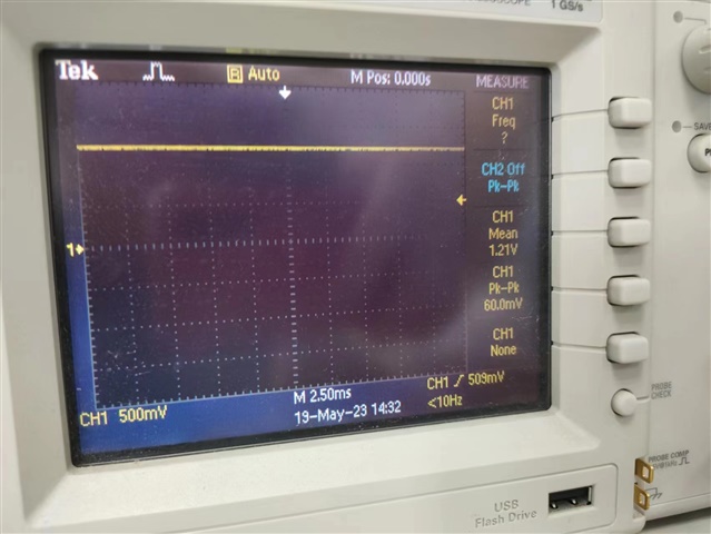

    Can you measure the supply using an oscilloscope.
    Please make sure you have sufficient caps on the supply rail.
    Sreenivasa

  • Hi Sreenivasa,
        The following is the 1.0/1.8/3.3/1.2V power rail. The 1.2V is for USB. Every rail is good.
        By the way, the DSP is supplied with a 24MHz passive crystal oscillator.
        Thank you.
    Frank

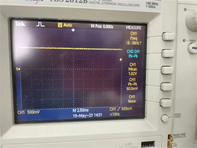

  • Hello Feng Xu,
    Please check the ripple on the 1V supply.
    Does the CVDD share the supply with any other devices.
    Sreenivasa
  • Hi Sreenivasa,
       No, CVDD is only supplied to DSP. The following 2 pictures shows CVDD ripple.
    Frank

    I do not see any major difference between 1.1 and 1V. Is this something you can manage?
    Would you be able to reduce the ripple on the supply?
    Sreenivasa

  • Hi Sreenivasa,
         I put 2 more 10uF paralleled with the original10uF Cap, to take 30uF.
        2 boards are tested, the issue persists.
        And I find the problem only occurs when the device is charging and taking SPI communication.
        If the device is not taking SPI communication, the problem does not happen.
        If the device is not charging, the problem does not happen.
        If the CVDD=1.1V, the problem does not happen.
        It's quite strange.
        I disabled the BQ25890 INT and BQ27441 INT in my program, so when charging, no interrupt is generated. But the issue persists.
        I compared the ripple on 1.0V, when charging and not charging, I think there is no difference.
        Thank you.
    Frank

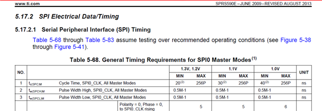

    I see difference in the SPI clock rates, have you tried reducing the SPI clock rate?
    Since this seems to be a system level issue, my suggestion is to review all the functions and interfaces and verify if there are any violations.
    With the information i have, i can only provide guidance.
    Sreenivasa
  • Hi Sreenivasa,
         I will have a try to low down the SPI clock rate.
         But my SPI is only 4M and 1.8M, which is far away from the 1.0V limination.

          I tried to set SPI0 & SPI1 to 500kHz, and nothing changes.
