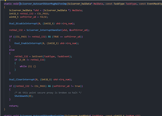

Hello, we found TiSci packet loss in PDK7.03 when Sci_Server was deployed in Mcu1_0. When the problem occurs, Mcu2_0 will get stuck in SciClient (Wait Forver). We suspect that Mcu1_0 did not timely feedback Sci signal, or lost Sci signal. We would like to know how to modify this part of the code to avoid packet loss. The screenshot below is the logic for our Sci_Server to process Sci.

    We find that Two packets of Sci signals are sent to Mcu1_0 at the same time. Mcu1_0 disables the interrupt after the first interruption and waits for the completion of the Sci Task before re-enabling the interrupt. In this case, the second packet of Sci cannot be processed. How to solve this problem.

    Are these two packets from different cores? If the same core would be sending requests to the SciServer, I would expect that the server could handle them all. How many cores are issuing requests? You mentioned that there is also an I2C driver running on MCU1_0, is this running as a separate task?

  • Hi:
    These two packets are from two different Cores.
    All Cores which are in Main Area will send Sci Request to Mcu1_0 within a very close period of time.
    I2C interrupt is in Mcu1_0 and We have ruled out the problem with I2C.
