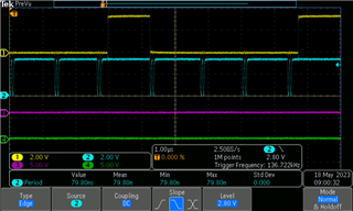

We are using QSPI on the AM4376 to communicated with an FPGA. Although we can communicate to the device, we've found the throughput to be to be unexpectedly low. When looking at signals on a scope, found that QSPI clock was not continuous, but in bursts of two during a single word transfer :
In the above capture, CH1 is CS, CH2 is SCLK, CH3,4 unconnected. We are using 8 bits/word and CLK MODE 3, 10MHz clock.
Are there any settings or combination of settings that can cause SCLK to behave discontinuously, as above?

  • The throughput is a symptom which revealed the discontinuous QSPI clock, shown in original post. The main concern is the discontinuous CLK behavior, which will in turn affect throughput.
    This is seen during a Linux QSPI transaction and also on baremetal. We are using 8 bits/word and CLK MODE 3, 10MHz clock. We can successfully communicate to the QSPI device, however the QSPI clock comes in bursts of two.
    Are there any configuration items that can lead to this behavior?

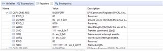

    Could you please share the OSPI configuration and allow review the below register
    27.4.1.10 QSPI_CMD_REG Register (offset = 48h) [reset = 0h]
    Sreenivasa
  • Hello Sreenivasa,
    These are the register contents after a transaction:
    Sorry if hard to read. QSPI_CMD_REG value = 0x003F0FFF
    WLEN = 0x7
    Peiman

    We are using the QSPI interface connected to an FPGA. Configuration uses, 1 wire transmit, 4 wire receive. We have tried programming QSPI clock to 10MHz and 20MHz. The clock period (measured on scope) corresponds to the programmed rate, but the clock idle time remains (seen above).
    Peiman
    Could you measure the idle time.
    Did you say it is same irrespective of the clock speed?
    Can you please capture the data signals with respect to the clock.
    Sreenivasa
  • Peiman, i think you have to determine how the Linux driver is sending data to the QSPI module and triggering the transmission.  There are four 32-bit data registers, so i think if you fill these up and then trigger the transmission, you should see more bursting on the interface.  Sec 27.3.1.5 explains the behavior.  I think what is happening is that Linux is taking a long time to retrigger the next transmission.  It's possible the Linux driver is just assuming single access 8-bit data and not attempting to burst any data.
