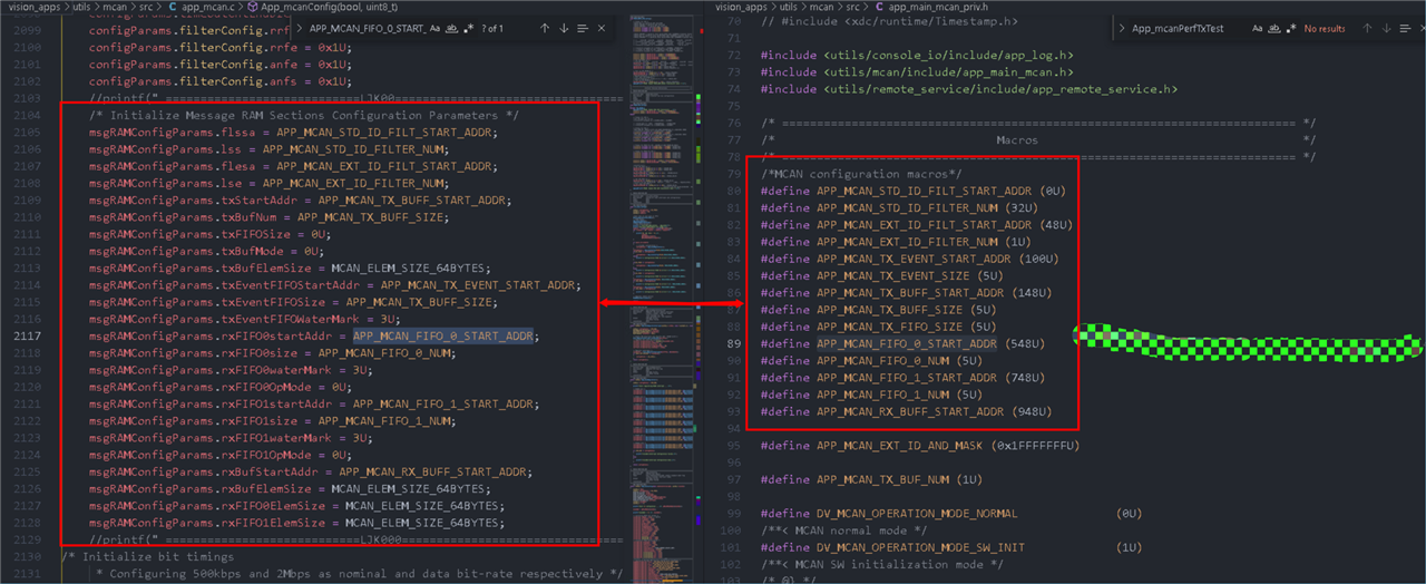

CAN code in sdk0804 is as below:
We modified filter number to 32, but there are only 25 ID message can enter the interrupt. Why can't the last 7 filter ID enter the interrupt?
Please give some help.
Thanks.

Up to 128 filter elements can be configured for 11-bit standard IDs. When accessing a Standard Message ID Filter element, its address is the Filter List Standard Start Address [15-2] FLSSA field plus the index of the filter element (0-127).
In example it is provided #define APP_MCAN_STD_ID_FILTER_NUM (1U)
and configured as below
it seems you write this app_mcan.c by yourself, so please also take care of the Paramconfig as well as the FIFO/RAM size and task stack size are enough to support your 32 numbers of messages.

How is the data being received , all coming at once or periodically ? Are you using Rx Buffer or FIFO ?
Is it possible to share the full application code so that I can try replicating this on my side on the EVM?

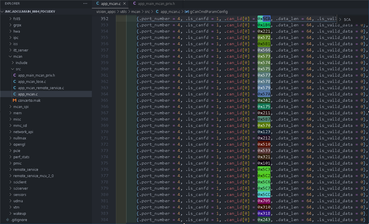

The data is received periodically. Yes, I am using Rx Buffer of FIFO.
The code is as below:
Please check it.
Thanks.

Hello Hongyao ,
As you said you are using Rx FIFO0 , if you aren't using RxFIF01 and Rx Buffer ,can you increase this
