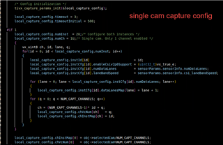

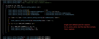

I am debugging front view cameras AR0233 using the app_single_cam, I wnat to capture 1920*1280 AR0233 raw image . Encountered the following issues
1)Using app_single_cam with default capture parameter configuration (instId==0). During the test, "Print performance statistics" displays fps with data, but the captured raw image is empty. I Open the attachment's "img_0000.raw" in binary and the display is all 0x00
As shown in the figure:
para code: single-cam-default-config.png

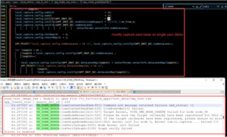

2) The front camera is connected to CSI2, so I configured instId=CSI2 to 2, but I found that VX was reported VX_ZONE_ERROR, FPS becomes 0, as shown in the figure
modify code :set-instid-2-error.png
log:AR0233-singlecam-set-instId-2-VX_ZONE_ERROR.log

    2) about commenting out call to app_send_test_frame API in the camera demo
    a) Modify as shown in the following figure
    b) run demo ,report bellow error
       - CAPTURE: WARNING: Error frame not provided using tivxCaptureRegisterErrorFrame, defaulting to waiting for forever
       - FPS becomes 0
       - last time , do not commenting out call to app_send_test_frame  , FPS has a numerical value
       - The detailed log is as follows

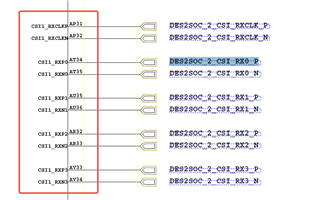

    On TDA4VH, there are three CSIRX instances, its not clear from the above picture which CSIRX instance is used. and when maxim deserializer output is connected to. Can you please check this first?
    Brijesh
  • Hello, Brijesh
    I have rechecked the schematic and found that the maxim deserializer is connected to CSI1-RX. Thank you!

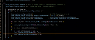

    Can you please try with below change?
        local_capture_config.numInst  = 1U;/* Configure both instances */
        local_capture_config.numCh = 1U;/* Single cam. Only 1 channel enabled */
            vx_uint8 ch, id, lane, q;
            for(id = 0; id < local_capture_config.numInst; id++)
                local_capture_config.instId[id]                       = 1;
                local_capture_config.instCfg[id].enableCsiv2p0Support = (uint32_t)vx_true_e;
    Brijesh

  • Hi zheng,
    Fullscreen
    1
    2
    3
    4
    5
    6
    7
    8

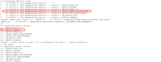

    Could you please do a quick test as mentioned below?
    -> Please undo the changes provided above.
    -> Run the application and when asked for "Select camera port index 0-11: ", Please provide camera port "4".
     (From your logs, I see that you had selected this as "1", but port 0,1,2,3 is for CSI 0 instance & port 4, 5, 6, 7 is for CSI 1 instance)
    Could you please test the above and let me know if this is working for you?
    Nikhil
  • HI Brijesh:
    I have tested and selected port 4, still NOK .  The underlying driver will run to 'UB96x_UYVY_TESTPATTERN', which is not supported by TDA4VH.
  • Hi zheng,
    Did not get it, what do you mean by "The underlying driver will run to 'UB96x_UYVY_TESTPATTERN'," ? Is it trying to enable YUV422 test pattern in Ub960?
    Brijesh
  • Hi :
    I mean choosing index 4 will load the camera driver of 'UB96x_UYVY_TESTPATTERN' and it cannot be used.
  • Hi zheng,
    Please select "4" for the "Camera Port Selection", not for camera selection. This option ie "camera port selection", will select the channel 4, which is virtual channel 0 on CSIRX instance-1.
    Brijesh
  • HI  :
    Yes, it is OK to test according to your method. There is no need to modify the code of the single cam, as long as you select a right camera index during testing.
