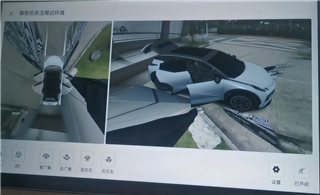

     we found any rendering abnormalities in the GPU after running our program multiple times for a long time(About two hours), like this,
     This phenomenon has now replicated three times,
     a)First time discovered on a real vehicle,Please refer to the attachment for the phenomenon , .After maintaining this for a long time, rotating at a certain angle and returning to normal, it no longer reappears.,     We also recorded PVRTune data0524-582.zip
     b)  The same phenomenon also appeared on the platform for the second time,the phenomenon of repeatedly running the program during this period is consistent, which lasted for about two minutes and then resumed
     c)  The phenomenon for the third and second times is consistent, but it shows anomalies in different areas

       This doesn't seem like a software issue, We speculate if there is a problem with the driver or hardware ?Have you encountered similar problems?
       Please help locate the cause of the problem, thanks!
