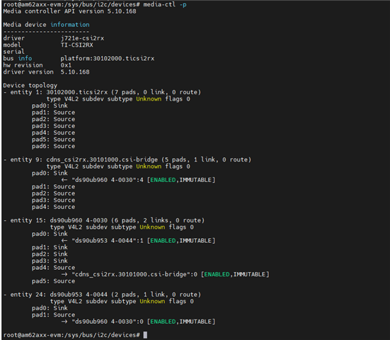

    Now the I2C works, customer can add
    imx390.ko、ds90ub953.ko、ds90ub960.ko. And 954 can be linked.
    But the topology is not correct, is there some other configurations he missed?

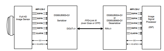

    Yes,customer is using SK-AM62A-LP board. imx390--->ds90ub953--->ds90ub954--->host controller. imx390 has integrated ISP, the output is yuv data.
    Shine
  • Hi Shine,
    Thanks for providing the diagram. I was asking how they connected the camera to our SK-AM62A-LP board. Are they using the Fusion board or UB954-Q1 EVM?
    Jianzhong

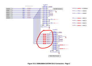

  • use UB954-Q1 EVM  connect to SK-AM62A-LP board
  • The UB954-Q1 EVM has two Samtec MIPI connectors. Which one are they using? I assume they have an E1 version of the SK-AM62A-LP which has a Samtec MIPI connector. Is that right?

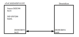

    Would you mind asking them to provide a picture of their complete HW setup (camera, UB954-Q1 EVM, SK-AM62A, etc)?
    Also just to confirm, their IMX390 camera module has integrated ISP, and the output is yuv data, so they won't need to use the ISP on AM62A. Is this correct?
  • UB954-Q1 use port0, yes,Samtec MIPI connector
    their IMX390 camera module has no integrated ISP,is raw sensor
    our IMX390 camera has integrated ISP

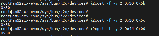

    We have 953 954 through, can access the register
    The current problem is as follows:
    csi-bridge has no connect to ticsi2rx
  • We're in a hurry. It's been a week. Please deal with it as soon as possible
    • The following is the structure of the camera module:
    ds90ub954 connect to SK-AM62A-LP
  • Hello Zhangpeng,
    The DS90UB954-Q1 EVM has two Samtec connectors as documented in the EVM User's Guide (note there is a typo in the highlighted text below: it should be J26 instead of J6):
    Which one are you using? If you're using J26 which is on the bottom and can directly connect with SK-AM62A-LP, you'll have to populate the zero ohm resistors. Otherwise, it won't work.
    An alternative is to use the J24 connector on the top. You'll need to make a few changes and use a Samtec cable to connect UB954-Q1 EVM and SK-AM62A:

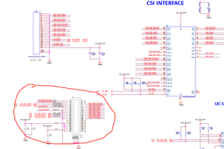

    • Configure J16 header on DS90UB954-Q1 EVM to choose 3.3v for I2C
    • Short jumper J23 on DS90UB954-Q1 EVM to use 0x3d for I2C address
    • Use a Samtec cable like this one to connect the Samtec connector on the AM62A SK to the Samtec connector (J24) on the DS90UB954-Q1 EVM.
    I'm not sure which IMX390 camera module you're using. If you use the one from D3 Engineering, it should work out-of-box with SK-AM62A. The device tree overlay for IMX390 is provided in the SDK and should be setup as:
    name_overlays=k3-am62a7-fpdlink-sk-fusion.dtbo k3-j721e-fpdlink-imx390-rcm-0-0.dtbo
    Jianzhong

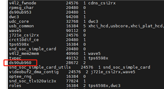

    • Now i2c is connected and can access register DS90UB954-Q1
  • Ok. Thanks for the clarification. If you use J26, you'll need to populate the zero ohm resistors on the bottom of the board, as documented in the User's Guide, section 4.4 MIPI CSI-2 Output Signals.
    Jianzhong
  • I have populate the zero ohm resistors on the bottom of the board
  • Ok. Very good.
    Can you do "lsmod | grep -e j721e_csi2rx -e imx390 -e ub953 -e ub964 -e cdns_csi2rx" on the board and share the result?
  • ds90ub954 drive i use ds90ub960
  • Yes, it's ub960. I had a typo there.
    Looks like imx390 driver was not loaded.
    By the way, you didn't modify any device tree, did you? The IMX390 should work with the SDK out-of-box, if you have:
