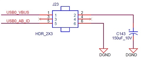

They’re referring In the page 25 of the TMDS64GPEVM Schematics (PROC101B(001)_SCH.pdf,
  • Can they eliminate the following circuit ?  If no 5V supply and only Device Mode, they think that this circuit is not needed.
  • Also, can they eliminate the J23 circuit below ?
  • In this case of USB Uniflash, USB0_ID pin can be No-Connect, right ?
    This is for the host mode, can be removed.
    We do not configure the role in the Boot. The USB_ID pin may not be required or used.
