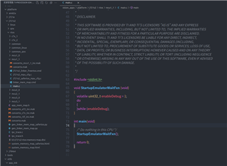

Hi Ti experts,
HW: owner board
SW:RTOS 08_05_00_11 SDK
1:This is mcu1_1 main.c :Why this hint "/* Do nothing in this CPU */" ,and nothing to do?
2:We want us appInit() funtion in mcu1_1 like mcu1_0,to achieve IPC.What should I do?
Thanks!!!

mcu1_1 is not really supported/validated in the vision apps. vision apps assumes that mcu1 subsystem works in the lockstep mode, so its not been supported..
