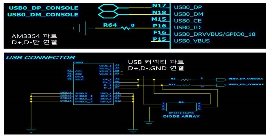

Customer would like to use USB0 with device mode and USB1 with host mode.
There are 2 questions.
1. How can it connected when use USB0 without VBUS from PC?
it will use only D+, D- and GND.
could you check below connection?
VBUS is floating and there is no pull up on D+
2. USB1 for host mode
USB1 is connected to LTE module and LTE module USB_VBUS is 1.8V.
Is USB available with only D+, D- connection to LTE module without 4.4V for USB1_VBUS?
or for host mode, is 4.4V mandatory on USB1_VBUS?

  • Hi David,
    This doesn't comply with USB Specification. VBUS is mandatory. AM335x USB controller doesn't function without USBx_VBUS pin connected, in both host and device modes.
    You would have to convert the VBUS to 5V for USB1_VBUS pin.
    No. See my answer for your question #1 above.
    Yes.
  • Dear Bin,
    I can't exactly understand the highlighted sentence in your TRM document.
    It means that if AM3354 is the device mode and USB is self-powered, I think voltage on AM3354 VBUS pin don't need to be sourced by host, right?
    please, check whether the below block diagram is possible to interface USB0(Device mode), USB1(Host mode)?
    - USB0_VBUS on AM3354 is sourced by DC/DC 5V on our board and VBUS is not used from usb connector(from PC)
    - USB1_VBUS on AM3354 is sourced by DC/DC 5V on our board and VBUS on LTE module is sourced by DCDC 1.8V on our board.

  • Dear Bin,
    I am hardware engineer and it's same project.
    The main purpose what i want to know is that it's possible to communicate AM3354 with PC through USB0 interface(Only with D+,D- signal) without VBUS0_VBUS on AM3354.
    Q1. As the mentioned on your TRM, let me know what's the meaning of the below sentence?
    "Note that both USBs are self-powered and the device does not rely on the voltage on the VBUS line
    sourced by an external host for controller operation when assuming the role of a device."
    Q2. Please, check the second block diagram whether is it possible or not.
