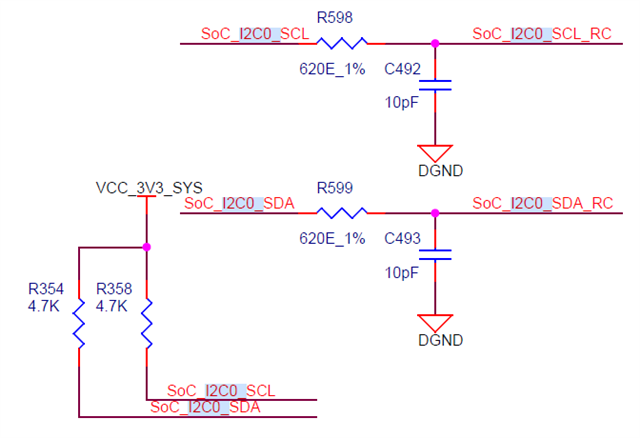

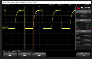

As the spec listed in PMIC I2C side , SCL low time must longer than 1.3us when in fast mode.
But according the test result , the low time is 1.26us, whether can be modify in 6202 side to increase the SCL low time?
If yes , how to achieve it?
