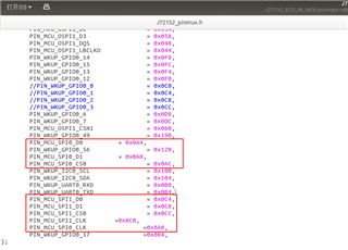

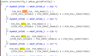

  • I have written CTRLMMR_MCU_SPI1_CTRL[0] SPI1_LINKDIS register as 1 in the software, and I can read the value of this register and print it out, which is indeed 1. Besides, I have configured it by pinmux according to the chip manual。
    Here is my pinmux:
    I don't know what the problem is, MCU_SPI1 piece selection signal can not automatically pull up and down

    I am suggesting an example of pin muxing MCU_SPI1 written in MCAL SPI driver examples to consider while writing into registers.
    /* MCU MCSPI 1 CS0 PAD configuration */
    regVal = CSL_REG32_RD(CSL_WKUP_CTRL_MMR0_CFG0_BASE + 0x1C0CCU);
    regVal &= 0x40001U;
    CSL_REG32_WR(CSL_WKUP_CTRL_MMR0_CFG0_BASE + 0x1C0CCU, regVal);
    /* MCU MCSPI 1 D1 PAD configuration*/
    regVal = CSL_REG32_RD(CSL_WKUP_CTRL_MMR0_CFG0_BASE + 0x1C0C8U);
    regVal &= 0x00001U;
    CSL_REG32_WR(CSL_WKUP_CTRL_MMR0_CFG0_BASE + 0x1C0C8U, regVal);
    /* MCU MCSPI 1 D0 PAD configuration */
    regVal = CSL_REG32_RD(CSL_WKUP_CTRL_MMR0_CFG0_BASE + 0x1C0C4U);
    regVal &= 0x240001U;
    CSL_REG32_WR(CSL_WKUP_CTRL_MMR0_CFG0_BASE + 0x1C0C4U, regVal);
    /* MCU MCSPI 1 CLK PAD configuration */
    regVal = CSL_REG32_RD(CSL_WKUP_CTRL_MMR0_CFG0_BASE + 0x1C0C0U);
    regVal &= 0x40001U;
    CSL_REG32_WR(CSL_WKUP_CTRL_MMR0_CFG0_BASE + 0x1C0C0U, regVal);
    Can you check this out ?

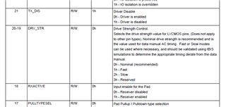

    Based on Tx and RX the following bits need to be set accordingly.

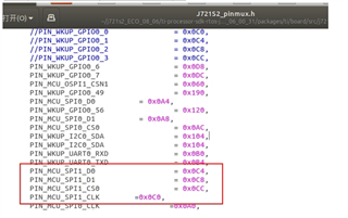

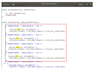

  • Hi ,
    I write register in the code and in J721S2_pinmux.h J721S2_pinmux_date.c directly write pin multiplexing, the effect is the same. MCU_SPI0 I am also in J721S2_pinmux.h and J721S2_pinmux_date.c write foot multiplexing. There is no other register to write it to. MCU_SPI0 works properly. My understanding is that the decoupling register of MCU_SPI1 was successfully written. pinmux is set up as in the manual. MCU_SPI1 should be able to send data normally. The data received by MCU_SPI1 is always the data sent, except that the slice selection signal cannot be controlled. Does it have anything to do with the setup? I'm using MCU_SPI in RTOS.
    No MCU_SPI1 doesn't have any extra steps other than the decoupling register.

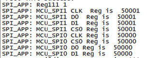

  • I sent data to read the version number of slave machine, and the MOSI signal was parsed out to be the data I sent, which proved that SPI was sent successfully. But the data I received (i.e. MISO signal parsing data) was still the data I sent, not the slave version number. I don't know why the data MISO receives is always same as my MOSI sent.
    Can you share the register dump at PAD config addresses for both MCU_SPI0(when its working) and MCU_SPI1 CS ,D1,D0 and CLK ?
    Is MCU_SPI1 being used in single channel master mode  or multiple channel mode ?
    Tarun Mukesh

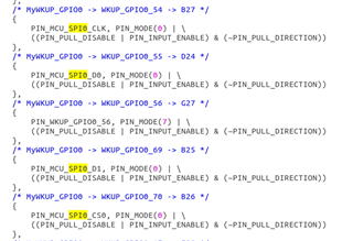

  • For MCU_SPI0 I configured pin multiplexing directly in pinmux, without addressing it in the code. Its function is used normally.
    MCU_SPI1 used single-channel mode。
  • The level of MCU_SPI1 selected signal is always high when SPI is not initialized and no data is sent. After the initial SPI configuration, the slice selection signal level is low regardless of whether data is sent or not.
    Can i get the values written in PAD addresses  for both MCU_SPI0 and MCU_SPI1?
    For Example MCU_SPI1_CS0  PAD we wrote the value in 0x4301C0CC Address
    regVal &= 0xFFDBFFF1U;
    Print the value at address  0x4301C0CC
    and also print the value of decoupling register as well.
    Tarun Mukesh
