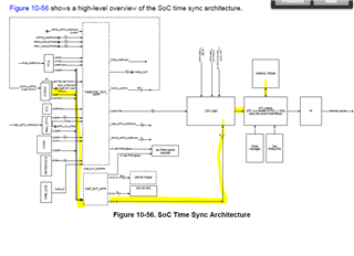

    I can say that for your approach, we can go with DMA auto-triggering since timing constraints are there in your requirement .
    Please look at the image below and check more details for DMA auto triggers.
    What we can do is divide into two UDMA channels. One is the TX channel, and the other is the RX channel.
    TX channel: sending data from SOC to ASIC for different time intervals
    That timing interval can be configured in the IEP comparators. Total AM64X has 8 comparators, so you can configure 8 time events, and based on those values, DMA will be triggered automatically.
    RX channel: Read data from the ASIC to the SOC for different time intervals.
    That timing interval can be configured in the IEP comparators. Here you can use a different comparator module, i.e., IEP1.
    All AM64Xs have 8 comparators, so you can configure 8 time events, and based on those values, DMA will be triggered automatically.
    I have attached the basic example code for the above approach for your reference.
    iep_triggers_memcpy.zip
