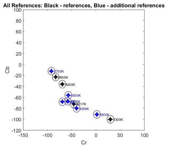

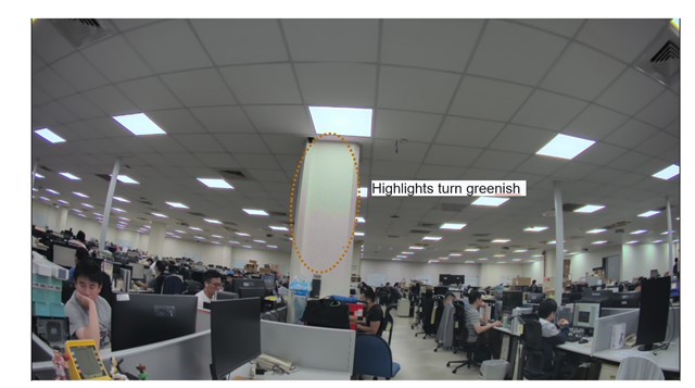

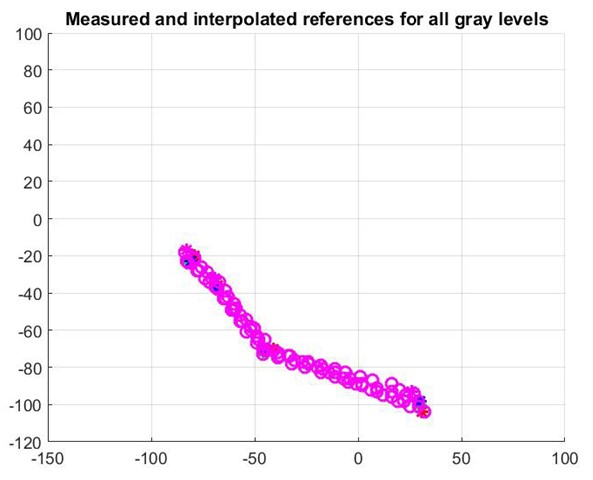

AWB WDR mode has a greenish in the highlighted area, which basae on j784s4-evm-08_06_00_14、J721e_evm and DCC tool TDA4VH v3.0. Our image sensor is IMX390
We have increased luma_awb_max to 65000 and still greenish
65000, // luma_awb_max
Attach the XML of AWB  IMX390_awb_alg_ti3_tuning.xml
May I ask what settings need to be checked for the phenomenon of greenish highlights?

    That looks like an issue of the Sony sensor rather than AWB.
    Sony mentioned that calibrating sensor settings with camera/lens module carefully may avoid this issue.
    I don't know the details on the sensor side.
    Please contact your local Sony support for more information.
