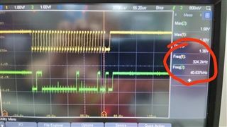

SDK version: 8.05
We are doing the ECU A sample bring up. We face a issue with the I2C rate. The I2C rate is only 320K when we config the I2C with 400K?  It is very urgent for us to it. Could you help analyze the issue. Thanks!
The code runs fine in EVM VL board before. Now the ECU change to use the VE SOM, I want to know does there any PLL or Frequency We need to change?
  • Hi Biao,
    Which i2c instance are you using? Also how do you measure that i2c frequency to be 320Kb? Could you please provide some more information on this?
    Brijesh
  • Hi. Brijesh
    We use I2C instance 4. Frequency of 320Kb is measure with the oscilloscope.

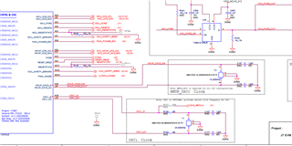

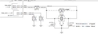

    We found a changes for external crystal oscillator. The EVM board using 19.2Mhz. Our ECU changes to 25Mhz.
    Does the pdk need to change?
  • Hi, Please check the waveform.

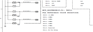

  • Hi biao song,
    Can you please check and confirm that boot pins (MCU_BOOTMODE[2:0]) are setup correctly to indicate 25MHz sysclock?
    Brijesh
  • Hi. Brijesh
    Yes. It is set to 25Mhz.

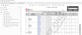

    On which pads, have connected your serializer/deserializer on i2c4? Are you using (AF28 and AD25) or (M23 and P24) balls for I2C4?
    I see both of below pinmux register are set for i2c4 output.. Can you please select i2c4 functionality only for pins that you are using? For the other pin, can you please change the pins to GPIO or other functionality?
    0011c010, value: 00050008
    0011c014, value: 00050008
    0011c0f8, value: 0005000a
    0011c0fc, value: 0005000a
    Brijesh
  • Dear Brijesh
    Indeed, according to the information you provided, modify the pin mode of AF28 and AD25 from i2c4 to MCAN: configure both 0x0011C010 and 0x0011C014 to 0x00050000, and i2c4 can work normally.
    Please tell me, taking AF28 as an example, I saw from the code that the pinmax configuration is actually 0x4301C010, why do you need to configure the register 0x0011C010?
    Liu
  • Hi Liu,
    Mode8 (ie value 00050008) in 0x0011c010 and 0x0011c014 registers is actually used for i2c4. So if you have i2c enabled on multiple pins, it may not work.. This is not recommended. Please enable the i2c only on the pins where it is connected to the slave device..
    Brijesh
  • Dear Brijesh
    Maybe I didn't say it clearly enough, please see the screenshot. What I mean is that the address seen in the register manual is 0x4301C010, why do you need to configure 0x0011C010 to take effect instead of configuring 0x4301C010?
    Liu
  • Hi Liu,
    Please use the register offset that i gave you ie 0x0011C010 and 0x0011C014. Location 0x4301C010 given in the datasheet seems also correct, but that may have to be used differently.
    Brijesh
  • Dear Brijesh
    We checked the code corresponding to configuring pinmax and the VM manual and found:
    1.0x0011C000 corresponds to the pinmax base address of the MAIN domain
    2.0x4301C000 corresponds to the pinmax base address of the WKUP domain
    The current I2C4 problem is caused by the pinmax configuration of AF28 and AD25 being multiplexed to I2C4. We modify the pin mode of AF28 and AD25 from i2c4 to MCAN, and the repair and verification is OK. Thank you for your support.
