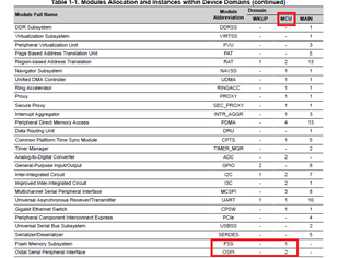

in SDK,fls can run in MCU2_1(MAIN R5) ,but mian R5 can not support OSPI and FSS,how to support FLS in MCU2_1?
1 Fls instance is supported by Fls driver implementation which is in MCU1_0 domain.But this instance can be accessed from main domain MCU2_1.
We have example in mcusw/mcal_drv/mcal/examples/Fls ,which does the same.

i know mcal can config fls in MCU2_1,but i want to know ospi can not support mcu2_1 how to achive fls run in mcu2_1?
now i has 2 AUTOSAR CP System run in TDA4,can i run fls in same time in different os?

Ospi can be supported from Main domain MCU2_1.Please look into the example mentioned above.
No this is not possible. You can use AUTOSAR on 1 core and use IPC to transfer data from another core.
