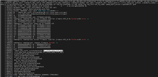

I have an issue when trying to map the ethfw Mac-only port to A72. Please help check my steps below:
Just use 1 MAC port:
Port cfg:
Virt port cfg:
Linux side device tree define:
When trying to boot the system, I got the log below:
It seems that the driver already recognized my setup but also through some errors. I just want to confirm: Is all my setting ok and Does the error log effect the result?
At booting done. I still cannot find any new network interface:
2. For the next steps. I'm trying to load the ethfw by running the vision_apps: /opt/vision_apps/vision_apps_init.sh
I also can see the log here:

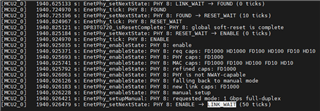

But there is still no new ethernet interfaces and when I add some logs, it show that my PHY seems stuck in the LINK_WAIT state:
Could you please help check and give me your suggestion?

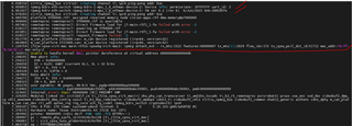

  • I'd like to update some more information.
    I've check for the details of the kernel error logs and it seems from the ti_j721e_cpsw_virt_mac
    Do you have any idea regarding to this errors?

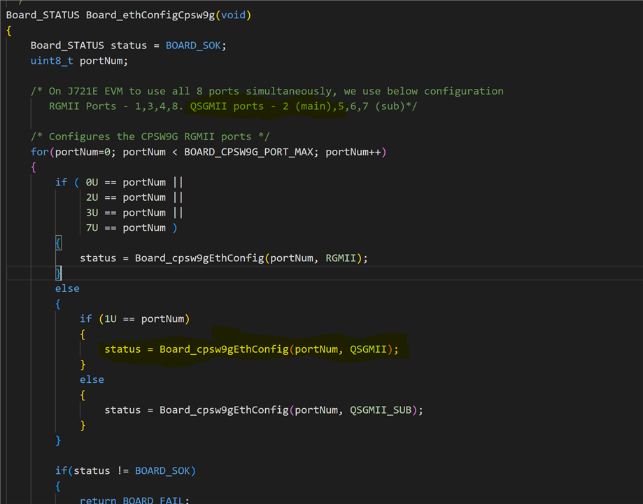

    Can you please confirm, are you using TI EVM for above testing? If so, Port-2 is mapped to QUAD PORT ETH EXP port on EVM.
    You have to use QSGMII and have QUAD PORT ETH EXP card connected to EVM.

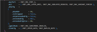

    If you have Separate RGMII PHY then configuration mentioned above will be fine, but can you check extended configuration as mentioned below were take care by writing the PHY or not?

    But about the issue about the ethfw keep loop in the Stage Machine: LINK_WAIT -> FOUND -> RESET_WAIT -> ENABLE -> LINK_WAIT -> FOUND
    Seems it missing something and unable to change to LINKED state.
    Could you please give some suggestion where I can check.

    Also, Can you please confirm that the Port-2 is configured in RGMII or not? by default in SDK Port-2 is configured in SGMII Mode.
    If not updated Port-2 to RGMII, check "Board_ethConfigCpsw9g" and invoke "Board_cpsw9gEthConfig(portNum, RGMII);" for Port-2 (portNum is 1 in below)
    Sudheer
  • Hi Sudheer,
    Thank you for your information.
    Its my mistake again, the Link Partner is not connect correctly so cause the Link status is not changed. After I fix my physical setup. All is OK now.
