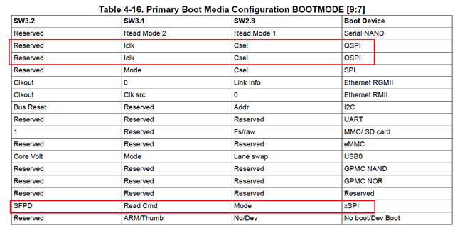

We are testing SPI NAND Flash on AM62x Customer Board, the hardware connection uses the OSPI0 interface, but the data lines only use four OSPI0_D0~OSPI0_D3.
If you want to boot the system from NAND Flash now, which Primary Boot Media should you choose? QSPI? OSPI or xSPI?
In addition, what's the three configuration options of Primary Boot Media mean (lclk,Csel,SFPD,Read CMD,Mode), and how do you configure them? Did not find their descriptions in the relevant documents
