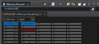

Hello Gokul, Vadivel,
Bringing the conversation from email thread to E2E:
In order to measure the SOC temperature from M4 core, you can follow the steps mentioned below:
(Adding an example below for better understanding)
Example
1.
2. 8095F = 00000000000010000000100101100001 -> 0101100001 = 353 (Taking 10 least significant bits)
3. a.
a. Substitute x=353 in the equation above and calc. the SOC temperature.
b.(-9.2627E-12)x(353)4 +(6.0373E-08)x(353)3 +(-1.7058E-04)x(353)2 +(3.2512E-01)x(353) +(-4.9002E+01) = 47.02384904775517°C
Yes, the AM62 SOC temperature can be obtained from Linux (in milliCelcius) with the below command:
cat /sys/class/thermal/thermal_zone*/temp
