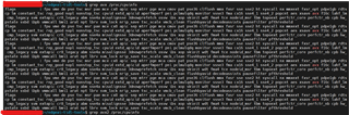

  • As per posted logs,
    "Illegal Instruction (Core Dump) "
    edeai-tidl-tools are built using libs which requires AVX/AVX2 support.
    Could you please confirm your machine is AVX supported ?
    You can use below cmd ,
    grep avx /proc/cpuinfo
    OR
    grep avx2 /proc/cpuinfo
    Pratik
    I would say AVX is supported, while avx2 no because nothing happens. Could this be the reason?
    From above logs looks like AVX2 support is missing in the current machine you are using.
    Running edgeai-tidl tools on AVX2 supported machine will resolve this issue.
    Pratik
  • Okay, then that must be the reason, thanks.
