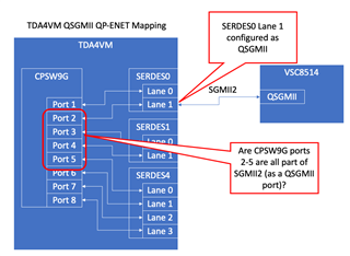

Based on the TRM for the TDA4VM, the CPSW9G (CPSW0) maps each port to a specific serdes and serdes lane.
In the QP-ENET expansion, when it is connected to the J7-EVM with TDA4VM, it connects to serdes 0, lane 1. This is called SGMII 2, which makes sense because it is connected to port 2 of CPSW0.
Based on other conversations with TI applications engineering, we understand that when using QSGMII, the specific port used (in this case CPSW0 port 2) and a selection of higher-numbered ports can be part of the QSGMII link. So, in this case ports 2-5. Or ports 2,4,5, and 6 (for example).
What we understand is the port 1 cannot participate in the QSGMII link. If we wanted to have port 1 in the QSGMII link, then we would have to connect a QSGMII PHY to Serdes0, lane 0. Can you please confirm or clarify this?

    I know that the QSGMII will use 4 ports of SGMII onto one serdes lane. I will confirm which ports it would use.
  • It’s intended to be flexible.  If Port2 is the QSGMII port then 1,3,4 can be QSGMII_SUB ports (or any ports).
    The lowest 3 QSGMII_SUB ports will be combined with the first QSGMII port.

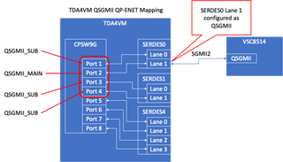

    Finally, is the following design also possible?
    In this design, Serdes 0, lane 0 (SGMII1) is designated as QSGMII_MAIN, while ports 2,3, and 4 are designated as QSGMII_SUB and would be grouped into the SGMII1 interface.

  • Hi John,
    Yes, SERDES0 Lane0 configured as QSGMII is possible.
